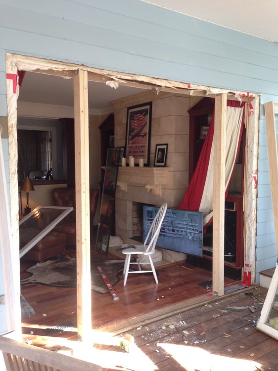

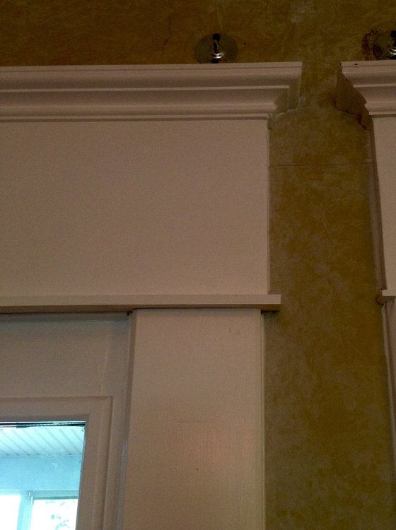

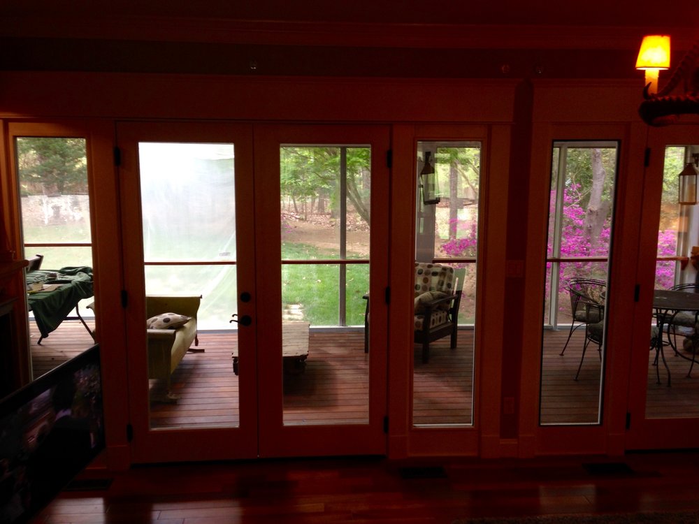

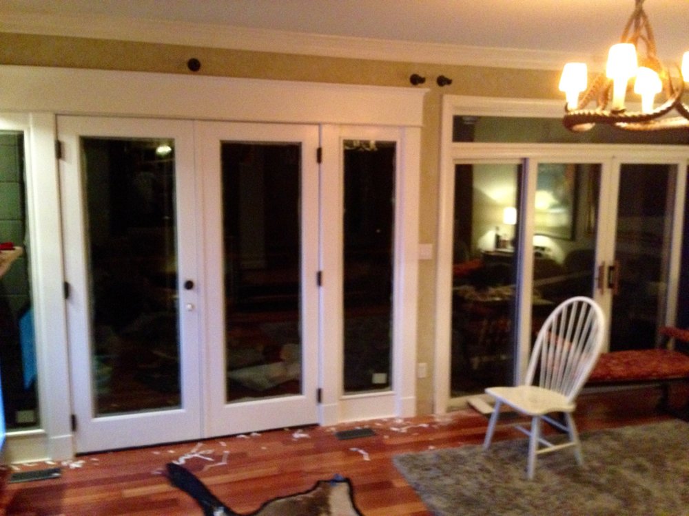

This has been one of the projects over the the Covid 19 season:
The 2 original sets of rear sliding doors, and sidelites on the house never had a roof over them, so they were already beginning to suck when we bought the house.  The beams were a bit undersized, so they were starting to sag a bit. With a bit of time on my hands the last few weeks, I finally got around to replacing them with new French style doors, and fixed sidelites.
I bought the new French doors as returned items, so I got both of them for what one set would have cost.

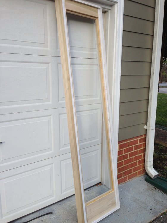

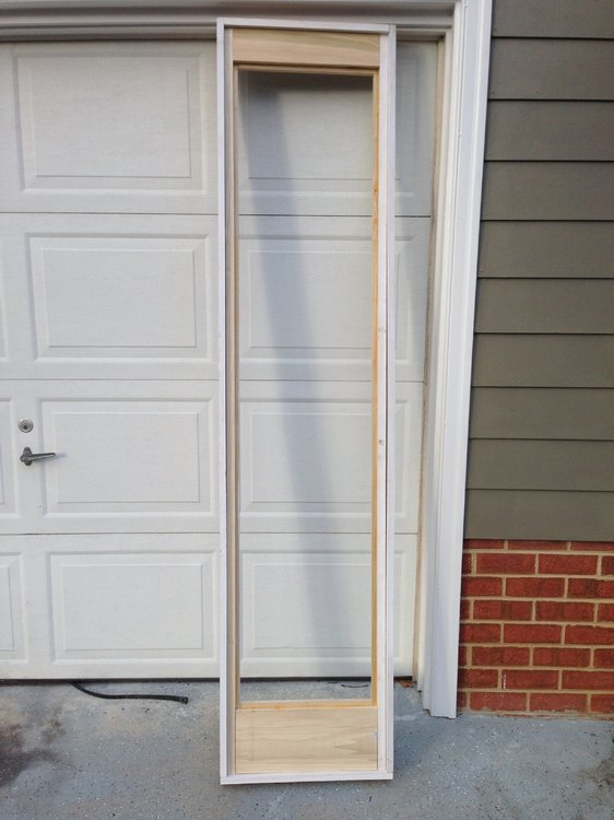

Then a glass vendor I work with had 4 pieces of insulated glass left over from a project. I got all four for just about what one of them would have cost.
I field built sashes, and frames for the insulated glass panels.
I ripped out the existing sets of sliding doors, and repaired all the rot I found in the sills.  The rear wall of the house was supported at 4 points (one at each corner of the 10' wide sliding glass door openings). The center wall section between the original sets of doors had the most point load, and actually settled about an 1" over 30 +  years.
Using French style doors allowed me to add (2) sets of additional posts to each set of doors, so the load gets divided into 4 smaller loads.  New oil rubbed bronze hardware.  I think the whole thing ended up costing around $3,800.  Retail would have been $6,000 for materials, and add another 25% or so for labor.
The original sliders are the set to the right.

This is damn fine work.  And, it looks like you didn't even fuck up your wood floors!  You saved a shit ton of money and the work is excellent from what I can see.

Much obliged. Don't look to closely, but it's pretty clean.  Yeah, saved a boat load of cash to spread out over a couple other projects.

I don't see stainless steel or copper door pans installed in the rough opening prior to installation of doors.

You roofers... always worrying abut water !!  You wouldn't see them here. I cleaned up the mess, and patched & repaired the bad sub flooring. There's now a screen porch roof extending out from that existing rear wall (built in '07), so water hasn't been an issue.  I didn't think they were necessary.
One detail I didn't get correct is the new side lite heads, and sills don't align with the door heads, and sills.  Because I was able to purchase  4 left over insulated glass panels for what 1 new panel would have cost ($250 for all 4 as opposed to $1,000 for 4 new units), I made the decision that wasn't a huge deal to me. If I was designing that for a client I would have specified they all align, unless there was some other reason I'd not require it.

Roofing AND flashing, home chicken.
Pffffft.... flashing......
