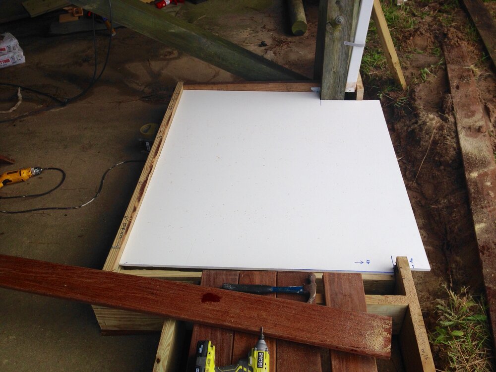

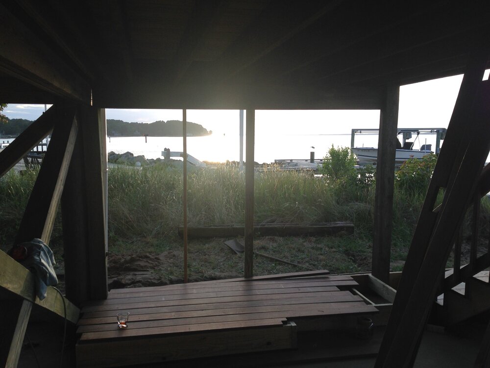

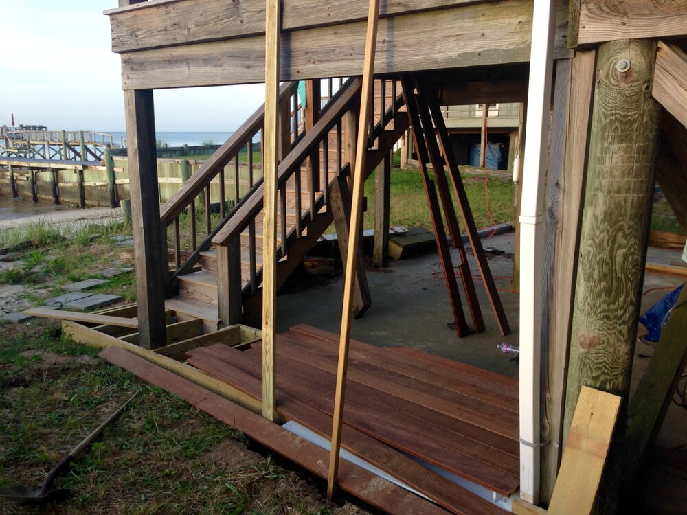

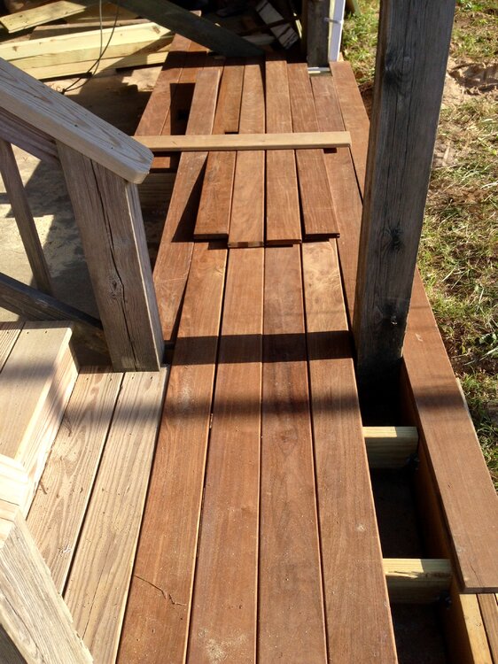

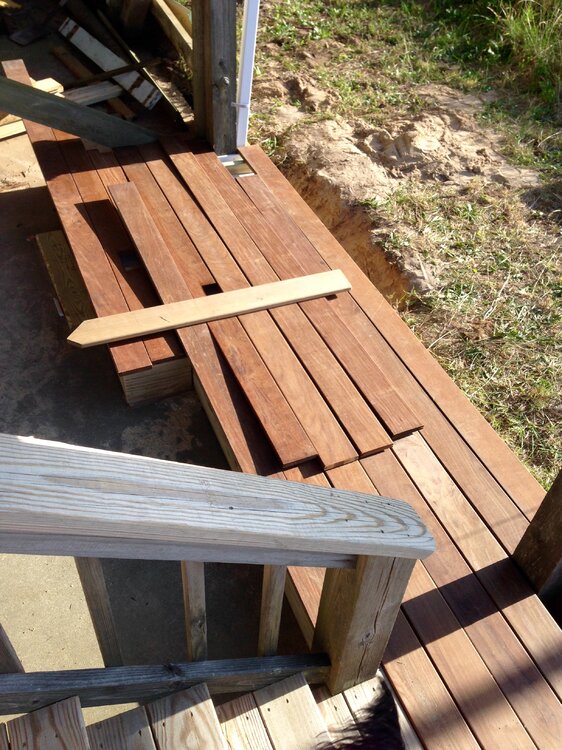

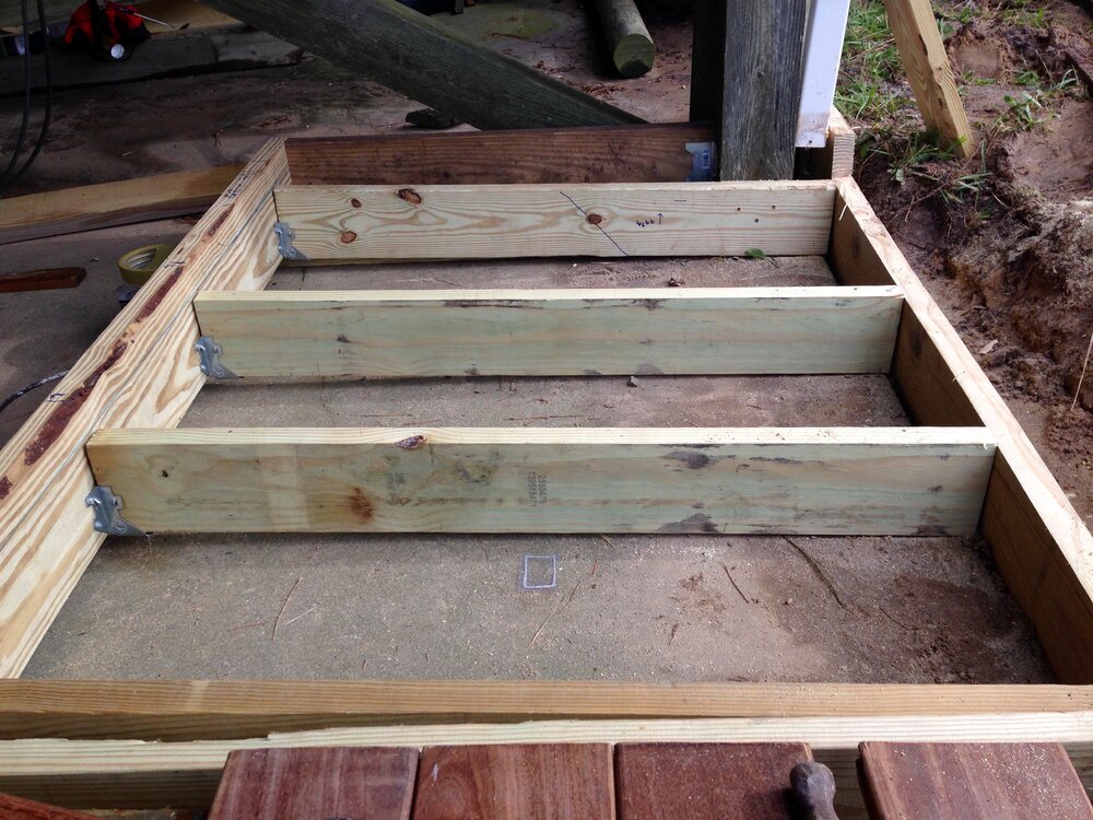

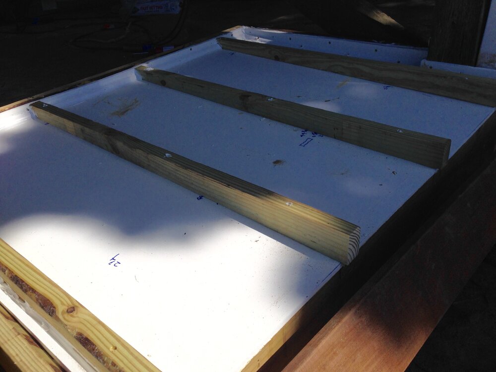

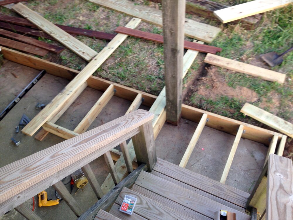

Started an outdoor shower project at the river house this weekend. I had some left over Ipe (Ee-pay) decking from a screen porch project at our home. I considered several different configurations. Even had the original shower location on the outside of the slab so water would just soak down into the surrounding sand lot.  Lots of reasons to alter that design, didn't want to block any views of my neighbors looking out to the water thru our lot, more privacy with the shower under the existing deck, and easier foundation framing (just used the existing slab, and framed it up, and off that surface).
After considering lots of options, I finally bit the bullet, and worked out a sloped shower pan so the whole thing could be located under the deck from above, and water is kept off the surrounding slab.
I used a sheet of 1/2" PVC sheet, and sloped, ground contact 2 x 6 lumber for the shower pan to be installed under the finished Ipe decking, and it will wash right out into the sand.  I'm thinking about an additional drain pipe in a geo sock, and gravel bed running along the side of the cottage (not really needed, but it's easy to dig out the sand so I'm considering putting it in as extra insurance).
I glued, and screwed all the sleepers, and the pan together, and added PVC quarter round to the 3 sides of the pan in a bed of caulk,  screwed all that into place, then covered the seams with a good bed of swimming pool grade caulk.
Next weekend I'll install the Ipe, grooved edge decking with blind stainless steel fasteners for the decking field, and then install a stainless steel fastened 5/4 x 6 mitered corner, edge border.  Ipe is a bitch to cut, and drill so I'm using the full length deck boards where possible.
I've designed a 2 sided slat wall privacy screen with ground contact 1 x 6's and  2 x 2 's.
Last step is the install of a 314 grade, stainless steel shower, and foot wash fixture.  The 314 grade is what they use for marine grade boat railings, and fittings so rust isn't an issue as long as you provide some periodic cleaning.   We're right at the mouth of the Chesapeake bay with salt water, and lots of windy, salt driven spray.  Anything not stainless steel will rust quickly, even galv. connections
More pics after it's finished next week.
FullSizeRender-301.thumb.jpg.54c0db189280736e0f6478df37ba9d42.jpgFullSizeRender-298.thumb.jpg.452c97a79bc0c8869630ae38681ce8ee.jpgFullSizeRender-299.thumb.jpg.b2c9f9e83a3e627242163d1d52837865.jpgFullSizeRender-296.thumb.jpg.54ee132284ffbdba66eeb36d0d00fed7.jpgIMG_0458.thumb.JPG.0ac16a835248e4602ef24a7def6978b8.JPGFullSizeRender-300.thumb.jpg.14da9c778cfeaf39d75e6022194d0db9.jpgFullSizeRender-295.thumb.jpg.d5ec23762a9e966dc0926057ebf12407.jpgFullSizeRender-294.thumb.jpg.4c743d67b7259ac58ea241468a9e2ec4.jpg

All that wood?  You must be a bazillionaire.  Nice humblebrag. ;)
Looking good.  Love that ipe decking.
we've been thinking about an outdoor shower too, will be referencing this for ideas, thanks.
Yeah, I've already thought about a couple potential modifications to the framing, and shower pan system before installing the decking.   The PVC, and wood  (especially when it gets wet) will move at different rates to I'm thinking about a couple little tweaks.
Did you use a palm nailer for securing nails to the joist hangers or just screw them in?
The work looks nice.  Great place, too.

Well,  not anymore....
We've had that Ipe sitting around since 2007 when it was $5.00 a square foot for materials, and fasteners.

Palm nailers are nice little tools. I used a Simpson hex head, heavy duty, galv. screw. The hangers are for a 2 x 4 but cost less than a dollar apiece. The 2 x 6 hangers were $3.00 apiece, and I needed about 28. They're more than enough to handle the load. I also put (2) 3" long, heavy duty, deck screws in the rim board faces.  I'll cover those with a piece of white PVC for a cleaner look, but also a little better visual at night.

Palm nailers are awesome.  Especially from driving small nails into joist hangers.
