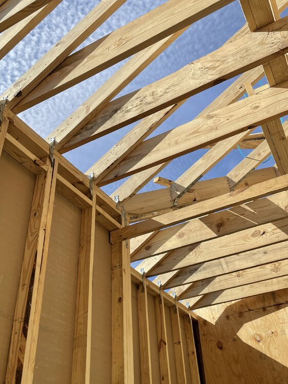

Wow. Lots of work there. Finished up?  Just saw you asked what part we were at. We have a place on Grover that we stay at some when not AirBnB’d. We stayed there thanksgiving through first week of January because we figured this was the last time we’d have a chance to do that with the kids stopping home school.
the structure is mostly finished. going to start plumbing tomorrow and electrical this weekend.
i’ll post some pics this weekend. very pleased with the work so far. i’m amazed by the condition of all the wood. was really worried that we were going to open up a huge termite nest lol.

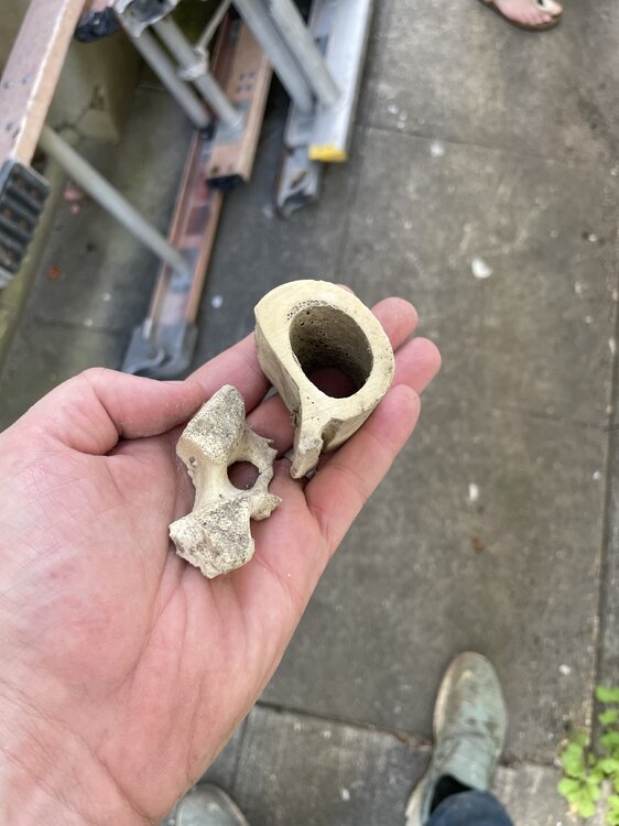

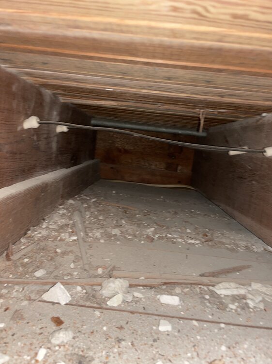

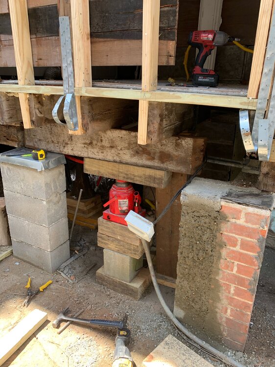

found some old bones while digging new piers.

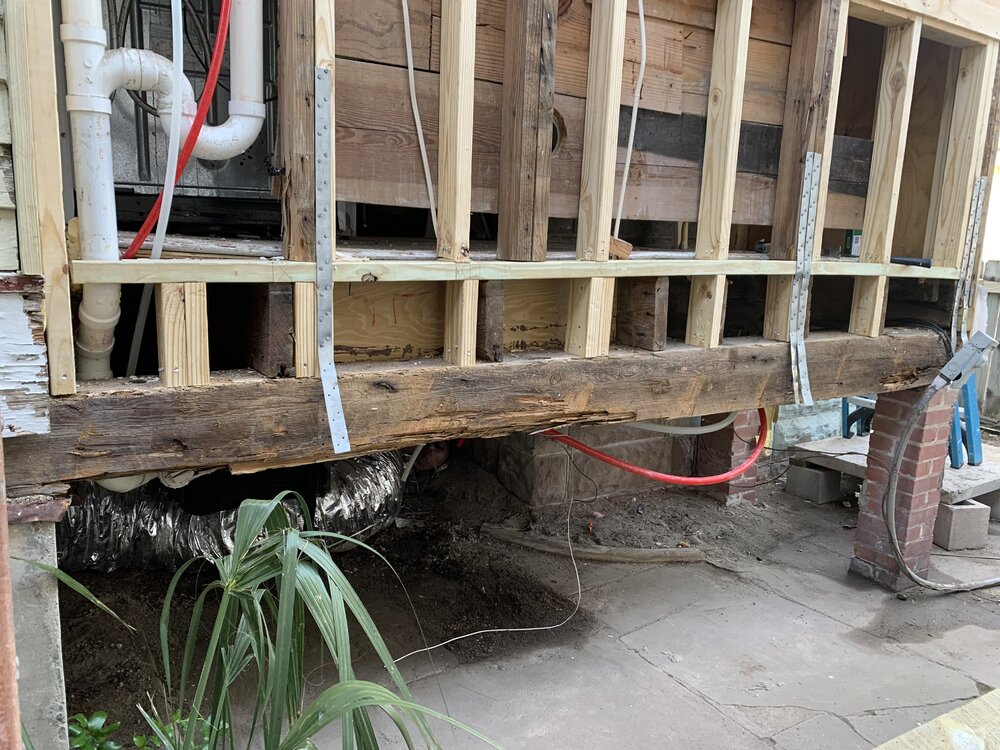

bonus pictures of the old rotten beam being replaced (the old package unit AC against it was leaking, causing excess moisture).
We replaced the beam and added new cement piers.  this was all a circa 1920s addition that we are building half of our new addition on top of

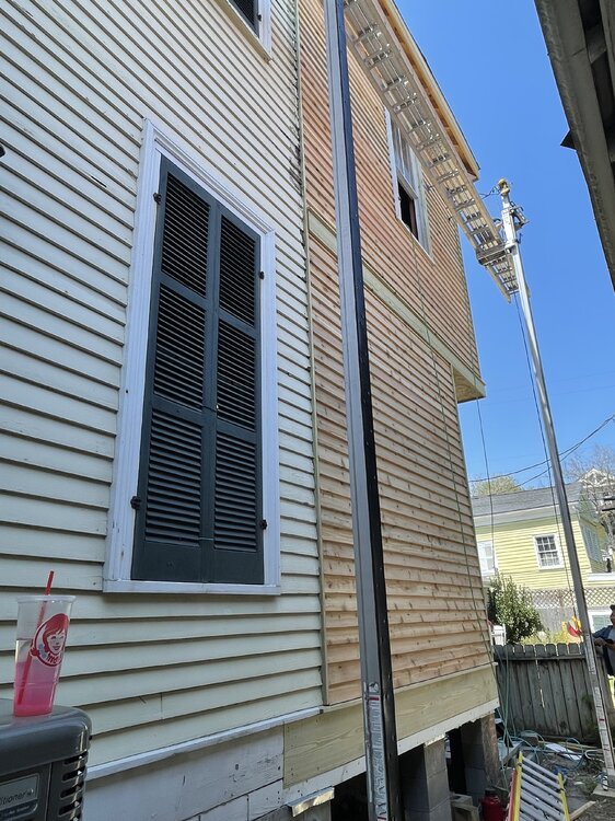

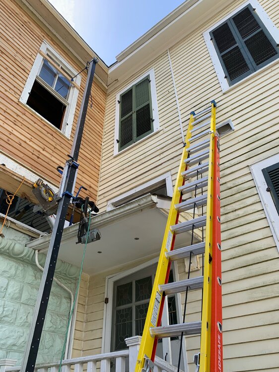

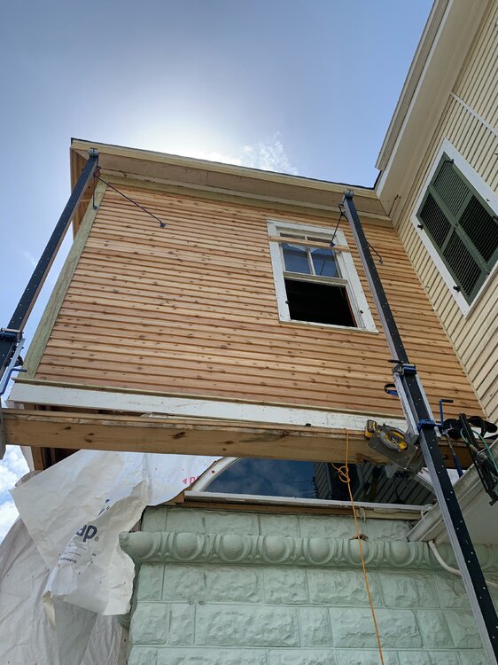

Is that scaffolding?  Haven’t seen that setup before if so. It would be mildly terrifying being the person cutting that beam out.

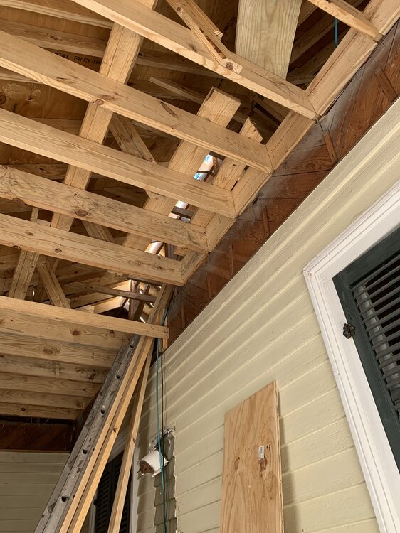

it sorta is? i’m not sure of the exact term. they only go up there to put the external stuff up, which is light weight.   the beam being replaced was under the first level.  so it was ground level. they added jacks and a temporary pier/beam setup before removing the rotten wood
47 minutes ago, CoTex said:
What are you going to do with the bones?
i just put them aside for now. i sent a picture to my archeologist brother who’s says they are probably from a pig or cow.
that said Durst lived 2 blocks down the street. lol.

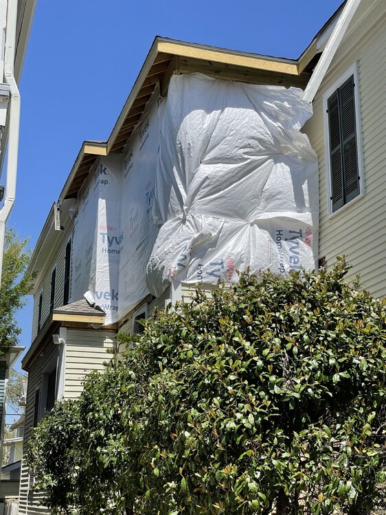

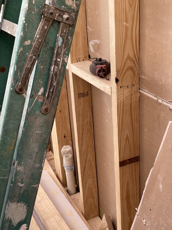

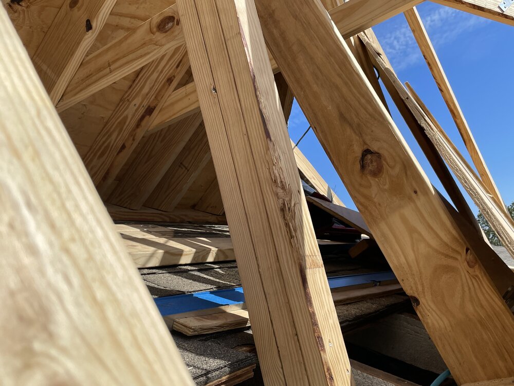

more pics from these last few weeks. A9C2B0A6-D69B-4A26-9FD6-CB81F58E0C8A.thumb.jpeg.fa525ac46b3c6e200b74ba837a27556e.jpegspace between first and second floor we opened up. hoped to find treasure, but instead found some old abandoned (unused) wiring and what looks to be an old gas line (house had gas lighting back in the day - also no longer used)
CB237BCA-3862-4393-83A6-AAE5DA4EC3C0.thumb.jpeg.3bc152ebf5fe34c57278a9114e45f061.jpegadding a new roofline above the future nursery / kids bedroom.   these are from a few weeks roof is 100% up now AA642936-B686-42D3-AA85-BE2D7FDFB4C8.thumb.jpeg.09396f33bdb6fc6f83d84c1018726d51.jpeg7D911939-C247-421C-AFAF-003BEFDB25AE.thumb.jpeg.5e7c195628a681668a1f11e694f175a5.jpegEAF4041B-0BF4-43ED-BB2F-B26FA31EAB15.thumb.jpeg.e8e5836c72e8461bcef8dd6b3281a86b.jpeg468DF52D-EE84-48AD-BB4E-D4DF206D583F.thumb.jpeg.47bfdc6cc3572673dc2eb4b5b9b84a18.jpeg17CD1884-C37A-49A6-A17F-A7888B1548E3.thumb.jpeg.4d8b67f1b20b3a9f69bfefc5c9ffc73d.jpeg

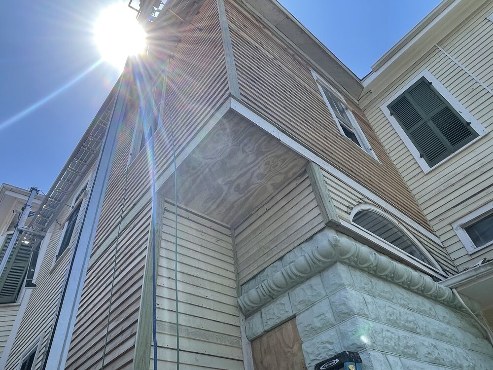

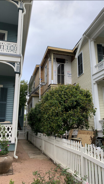

rear addition (new master bathroom) siding now up. we reused the original cypress where was possible and new cedar where needed.  we also reused all the original windows
the front addition (nursery) is next.
should be finished with rough end plumbing and electrical monday.
cool fact. the masonry structure we are partially building on top of is the old icehouse (eventually going to be a walk in wine “box”).

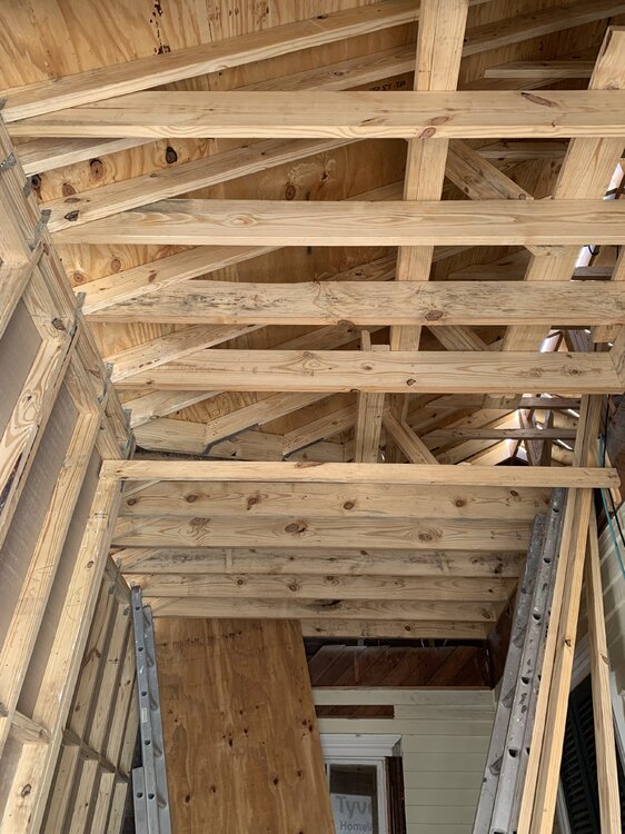

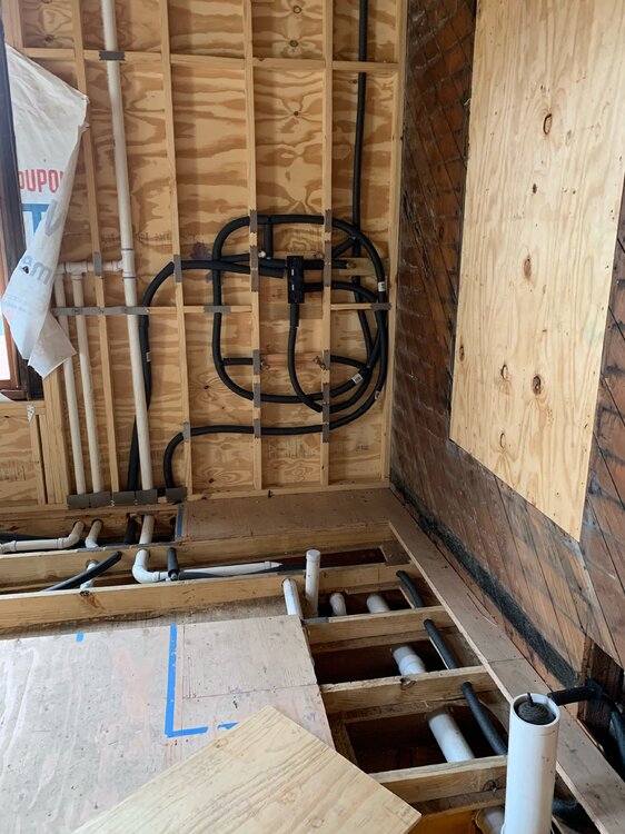

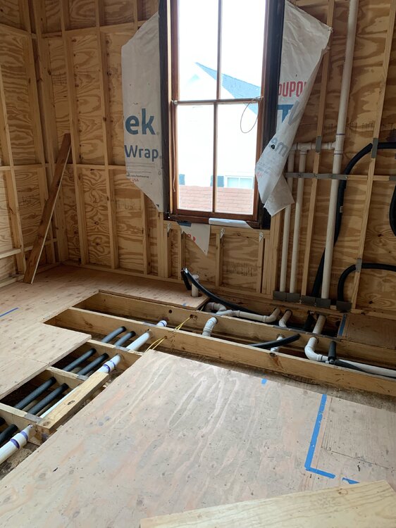

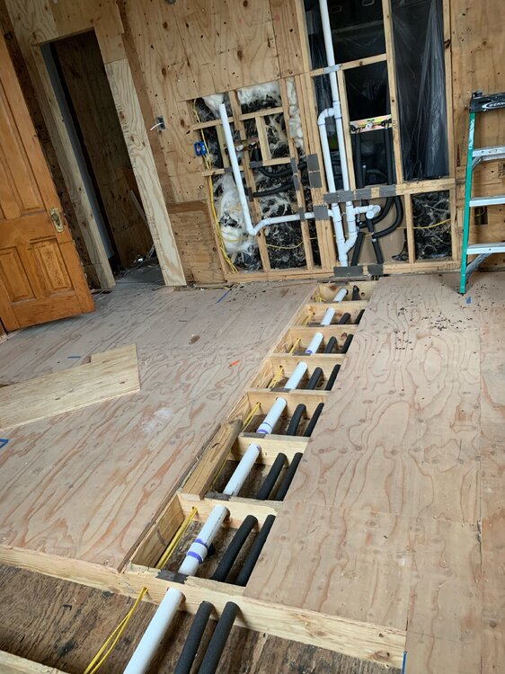

hopefully i’m not annoying y’all, but here is an update.
front bedroom/nursery finally getting siding.  new master bathroom is finally fully plumbed.
5EFC8148-C7A9-46C2-A151-B275B32D4AA5.thumb.jpeg.818ac1694808cfda0aaa89d9738d481b.jpegtesting out the new color. looks good imo

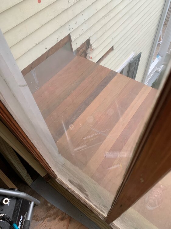

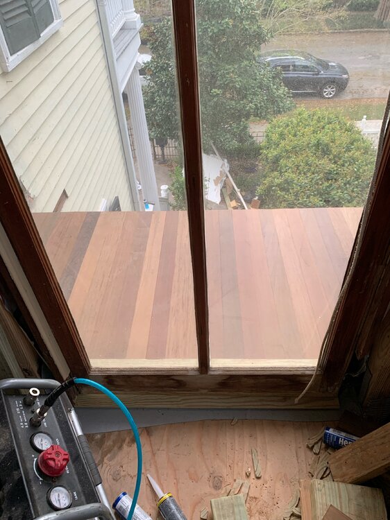

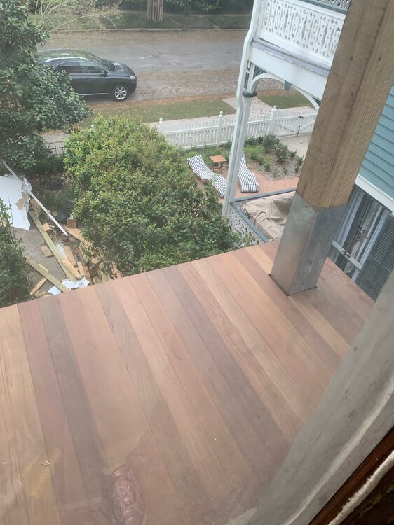

minor update.  been waiting on inspector, so kind of in holding pattern.   insulated plex piping, built the small porch off nursery, and added more siding.  starting to see the finish line, which is great since my wife’s due date is less than a month away.
hope this little epi experiment works out.  if it does i plan on replacing other two porch decking in the next few years

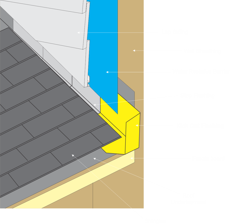

No flashing kick out.  Cardinal sin.  Call back your installer.
#1172
Although this diagram is for comp shingles, you will get the idea.  Metal needs to be semi-precious variety: copper, lead coated copper, 316 stainless or aluminum.

thanks. i’ll bring it up, would you want it there even if it’s a covered porch?  it should not be seeing any direct rainfall (other than wind driven).  the roof above will have a foot or so overhang plus 6” gutter.

Absolutely.  Anywhere on the structure where that construction condition exists, be it roof or balcony, and a flashing detail ends at siding.  Kick outs are a must.
Needs to be a monolithic and soldered detail.

I mentioned semi-precious metals because of the salt air environment on the island.  Aluminum was on the list; however you won’t be able to solder aluminum.   Galvanized, bonderized (paint grip) or any pre-finished metal with G90 galvanized as it’s base material is a no go.  It will all rust in short order.

Yep no aluminum you need copper and not the thin gauge  shit.
