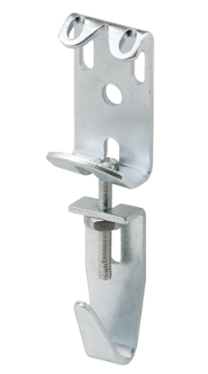

How have I never run across one of these before?  A pair came with a new mirror wife bought.  Adjustable J-hook hanger. allows for adjusting up/down easily for when you don't get hole just perfect or hangers on picture/mirror aren't perfectly level.

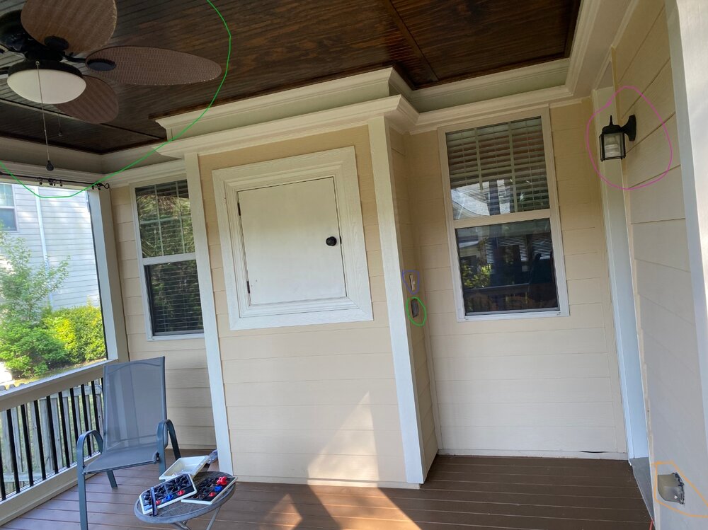

ok I think this is the right thread, looking for some smarter opinions on what dumb thing I'm missing or if I need an electrician or what
We have a screened in porch.
It has a ceiling fan with a light, some rope lighting around the edge (in the molding or whatever) - those are controlled by the three covered switches circled in green. They have worked in the past, as recently as early to mid april when I was out here mopping the pollen off at night.

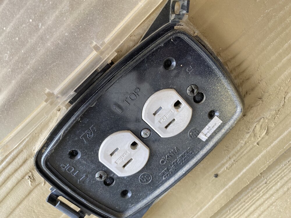

It has an outlet (circled in yellowish orange). It has never worked as long as I've lived here. I've made a few feeble attempts at figuring it out and have had a contractor who has done some small repair projects look and we haven't figured it out. There's another outlet on the side of the house nearby, same deal.
It has a porch light (circled in fuchsia) which is controlled by a switch on the other side of that door and works.
It has speakers in the ceiling that are controlled by the volume knob (faintly circled in blue) above the light switches. Those work. There are also speakers in the kitchen and the master bath upstairs that all connect to the same sonos up on the third floor, they all have independent volume control in the wall like this guy does.
Anyways, obviously I've checked the fuse box multiple times and have toggled the breaker for this area to see if that would bring to life either the outdoor outlets or the light switches. The outlets are... I think GFCI protected but don't have a reset button or anything. I've meant to get an electrician out for the outlets but haven't gotten around to it/i think it's been hard to get anyone out for small jobs for a while but that may be getting better.
The switches are the thing that I'm trying to figure out right now - I would like to be able to turn on the light/fan/rope lights. My working theory is that the cleaning lady flipped a switch somewhere that somehow turns that whole circuit or whatever off or on. There are 20 switches in the downstairs main living area on the other side of those windows and I've walked around trying to toggle them all to see if it would bring the porch fan/lights to life. Haven't found it yet. Maybe there's something weird (switch somewhere more random that does this) - I know that a lot of the porch stuff was done after the house was built, it wouldn't surprise me if there was something weird.
Any thoughts? Is there some crazy obvious thing that I'm not trying or haven't thought of? If I can't figure it out, is an electrician who I need to just figure out the whole thing?

Yeah I’m dumb but not that dumb. Although I still keep trying to find some chain/switch combination that maybe I’ve missed.
Nothing dumb about it. You get used to it being on and using the switch, someone else comes by and pulls the chain without thinking.
Check all the breakers in the box. Could be one mislabeled. Check the plugs and GFCI’s. They go bad.

dumb question - does this type of gfci outlet have a switch somewhere?
#1276
That’s not a gfci plug. That sticker just says it’s a protected outlet. It’s either down stream of one or there’s a breaker in the box that is.
#1277
Yep. GFCI and "GFCI protected" aren't the same thing.
Get yourself one of these
https://www.amazon.com/Receptacle-Tester-Klein-Tools-RT210/dp/B01AKX8L0M/ref=sr_1_5?crid=3BC29560IAC0G&keywords=gfci%2Btester%2Bplug&qid=1683678018&sprefix=GFCI%2Btester%2Caps%2C220&sr=8-5&th=1

Yep, that plug likely has a circuit flipped somewhere else.  Usually outside stuff seems to be connected out in a garage for some reason.  Probably just easiest to tie it in.  Could also be a GFCI somewhere else outside.
Easiest way is to literally just go room to room and look at every single outlet.  Trip any GFCIs and reset them.  You probably have a plug somewhere you just don't use/don't see and it's tripped.

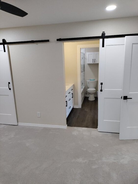

I had a unique condition in our new house where barn doors were the only practical option.  Stairs on one side, so no swing door.  Wet walls on both sides of the opening, so no pocket doors.  And, we have 12' ceilings and wanted a minimal header.  So, the result was building some 11'3" x 2'6" biparting barn doors.  Used some leftover reclaimed oak we had from another part of the house over 3/4" plywood cores that were glued and pocket screwed together.  The build was fun, but hanging them is going to be a challenge.
Are you considering a powder coated metal frame around the edges?

On 5/16/2023 at 7:15 PM, RMac5 said:
I bet those barn doors are heavy. I will be building a barn door in the near future.
My son did a couple barn doors when he renovated my granddaughter’s condo…. One for her bathroom and one for the closet.
That's exactly what I did at the last house and it looked great.  Added some horizontal cross braces as well for some detail since it just had vertical slats.  We may do that on these as well.  It would be super easy to pull off the wood trim I put around it and replace it with steel.  We have a blackened steel fireplace in the master bedroom, so if we go that route, we'd probably just blacken the steel.

1 hour ago, Celery Man said:
I’m not an electrician but I don’t think this is even wired up.
IMG_2635.thumb.jpeg.886d6950b306179e54368e1a5a86a713.jpegIMG_2634.thumb.jpeg.148f279965f3a29052720fc7f527be96.jpeg
That would definitely seem like you found the problem...
