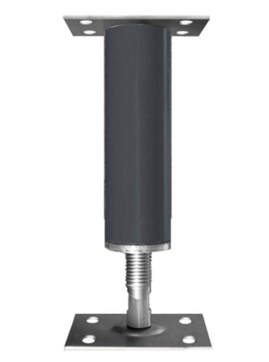

It seems to me that houses should be built with those gadgets. It would sure simplify things. These are the joists that I think they should be attached to so you wouldn't have to worry about sagging or creaking. And as onboard has mentioned, the crawl space should be conditioned so that water isn't a problem. Water is going to foster bugs and rot in the foundation.
