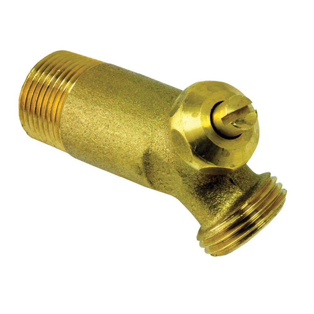

PS:  A plumber suggestion is to remove the existing plastic drain valve (like a hose bib) & replace it with a brass one (sold on the same aisle, costs $ 9.00 or less).  The plastic one can take a single knock by your foot & it's broken off inside the tank exterior.

Another item, remove the existing plastic drain valve (fancy for "hose bib") & put in this one:
everbilt-water-heaters-drain-pans-eb1211
The plastic one can easily get damaged, knocked off, etc.  Costs less than $ 8.50.
Store SKU #1000042101
  • Durable material resists rust and corrosion
  • Allows draining of water heater for prolonged life span
  • Tamper proof, no accidental discharge

Opened, in position... new unit comes with a brass valve ROTB, so no need to add on / swap out from plastic.
$ 8.88 + tax saved is $ 8.88 + tax is money earned.
#28
You want a brass full port ball valve. You only solve half of the problem with a brass globe valve.
House Mods HMP010 Brass 3/4" MIP Water Heater Replacement Drain valve(Full Port, Ball Valve, 2 inch Shank) https://www.amazon.com/dp/B074DGWLXZ/
Put a cap on it when you’re done.
Twinkle Star 4 Pack Garden Hose Brass Hose Cap with Washers, 3/4" https://www.amazon.com/dp/B07L3R2Y3L/
