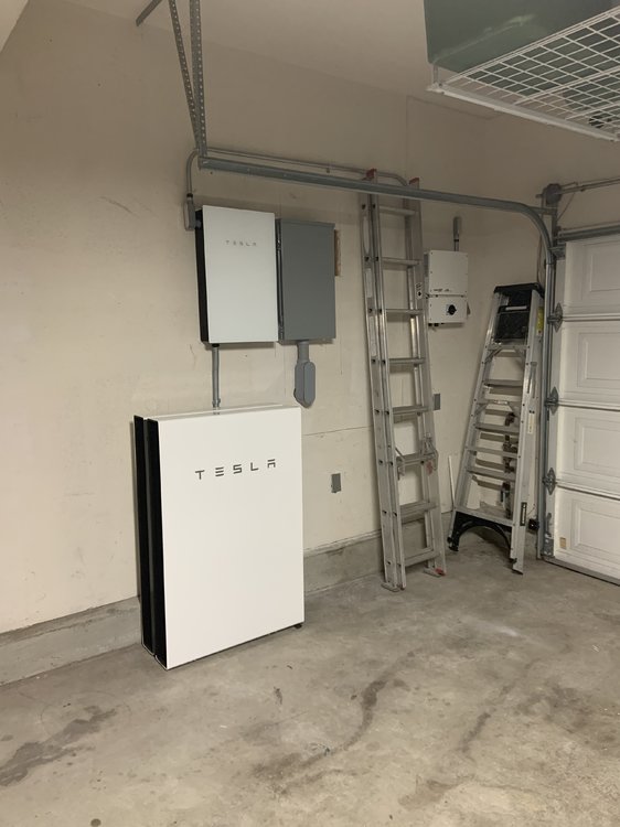

I just put in my order for panels and two powerwalls today.  Not 30 minutes after... boom, first power outage in my neighborhood in over two years.

The Powerwall storage system is the break thru (hopefully a break thru) that may make solar actually viable.

No powerwall.  They offer it, but it's not part of rental.  It's straight cash homie.  I never imagined going off the grid, so I never gave any consideration to the batteries.
Tesla keeps the tax credits.

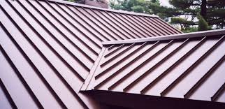

In our experience shingle roofs and panels don’t mix too well.  Further, tile roofs and panels REALLY don’t mix too well.  Both because the flashing kits provided by the panel system manufacturers are not good, require shingle or tile roof penetration work and lots of panel installers say “we know what to do” and they really have no clue and use a lot of plastic cement to cover up their butchery.
Standing seam metal roofs and solar panels go together nicely as the flashing kits can clip-on attach to the standing seam with no roof penetrations for the panel stands and then penetrate where the wiring harnesses go through the roof.

We will have a standing seam roof in the design but I’ll ask about clips. Gf is the builder and she’s a rabbit hole researcher so I’m sure she’s gonna look at it.
"S-5 Clips".

14 hours ago, deadshank said:
Take the panels off, re-roof and re-install panels.
Dumb question amnesty: What is a "standing seam" metal roof? Is that better than a "normal" metal roof?
16-24" wide x 8-20' long metal pans with the edges turned up about 1-2".  Set side by side one of the 1-2" turned up edges is turned/crimped  over the next edge or a pre manufactured cap is installed over those turned up edges.  Hand crimping looks best, and is the most authentic methods.
The solar panel will attach to that turned up edge connection instead of penetrating the flat panel, making for a superior system
Edited by Onboard 2.0
Ah, so no exposed screws = less leaks I assume? But also harder to replace the screws? I assume the rubber gaskets on the screws last longer since they are not in the sun?
Correct, and the penetration in the turned up seam is above the roof plane where waters sheets off the roof, and will eventually leak thru any screw that has penetrated it.  It's a great roofing system, and is not cheap, but not like the price of slate, mission tile, or copper.  It's prevalent on old farmhouses as a classic American look, and would have been tin and painted with a red, green or silver paint every few years.  Today they come with a baked on color or metal finish or are built with real copper $$$$$$$$.
#94
Everything @Onboard 2.0 said plus a little more nuance that I won’t go into.
Onboard2.0 is my paid celebratory spokesman/gender-neutral entity
@ROFL BOX does this kind of stuff, too, but mostly re-roof stuff in the greater Austin/SA area where as I do primarily new construction and a good amount of re-roofing in Houston.
I’m a lot better looking and more fun to be around than both of them.

#99
8 minutes ago, Guadaloopy said:
I am geeking out, y’all.
Can't wait to see the damage to the battery and the car on the "stupid wives" thread
#100
1. She does not park in the garage.
2. She has already been on me about building some sort of protective cage system around it to prepare for a day when she MIGHT want to park in the garage.
