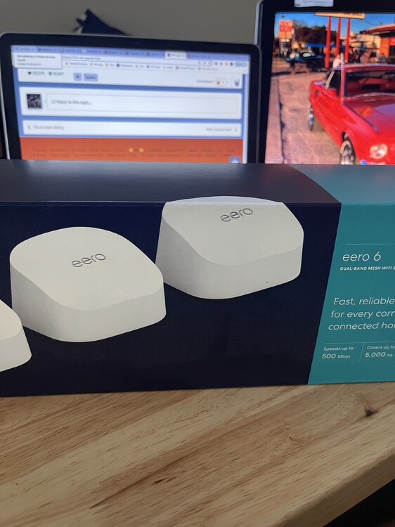

Necro bump so I don't have to start a new thread.
My sons' rooms are on the opposite side of the house, and upstairs, relative to where our wifi modem is connected.  Their Roku's are glitchy.  I just ran a test and the rooms came in at 50 and 70 Mbps, which, from what I understand, should be more than enough to support a Roku w/o issue.  Granted, I ran the tests with most of our devices off - i.e. optimum bandwidth.
Assuming wifi strength was the issue, I just purchased an Eero 6.  I was under the impression that I would just connect this to our current modem, place it in one of my boys' rooms, and, presto! - stronger wifi.  Is this not the case?  From what I've read (above) and found on YouTube, I'm being led to believe that I would need more than one Eero for a mesh system to work.  I'd need one to replace my current modem, then another to "feed" off of it.
TL;DR - Can I connect one Eero 6 to my current setup, place it in a room on the opposite side of the house, and enhance wifi strength OR do I need of minimum of two Eeros for this to work?
@Twicehorn - Halp mountain bike buddy!

you need something in the middle of the house.  any device on that side of the house is going to be using the shitty reception over there.

My Eero 6 came with 3. 1 plugs in and other two are wirelessly connected for the mesh.
you only got 1?

Correct, one becomes your new "modem" and you need one or two more from there.  Putting a 2nd at the far end doesn't help...needs to be in the middle so it has good reception to the 1st one.
#31
Thanks y'all.  I didn't realize until the single unit arrived.  I tried to bridge it with my existing modem to no avail.
Then, I tried to move my modem/router to the middle of the house.  That didn't work either.  I don't have any connections outside of our study.
Settled for a wifi extender, which I just hooked up.  Working like a charm...
