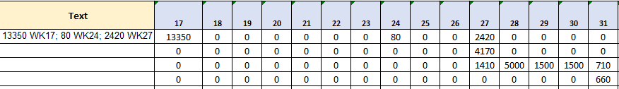

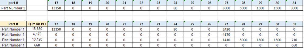

so is this possible with excel?  I have a table with Weeks for col headers and qtys in certain weeks.  I want to create a cell (Text col) that will list each qty by week.
Is there a way/function to do this?  Parse a row, grab non-zero values, and then combine the qty with the corresponding week.  I think i could do a massive IF chain tied to INDEX, but wondered if there was more elegant solution

I'm not quite understanding why you'd need an INDEX function at all. Based on your example, you're not looking at other rows. You're just parsing each row within itself. That said, assuming you have 52 weeks, I'm not entirely sure you could use a single cell to add all the IF functions as there is a character limit. But it looks like it should be ok if you use the following:
=IF([@1]>0,[@1]&" WK"&Table1[[#Headers],[1]]&";","")&IF([@2]>0,[@2]&" WK"&Table1[[#Headers],[2]]&";","")&IF([@3]>0,[@3]&" WK"&Table1[[#Headers],[3]]&";","")&IF([@4]>0,[@4]&" WK"&Table1[[#Headers],[4]]&";","")&IF([@5]>0,[@5]&" WK"&Table1[[#Headers],[5]]&";","")
Just continue the pattern to 52. I did this assuming you make this an Excel Table named "Table1" and with the headers you have in the first row rather than just a range.
I really have no idea why you'd want to do this though. It seems like there is probably a better way to format your data and accomplish your task. Why do you have multiple rows in the first place? What is the point of the Text column?

thanks, i will take a look at that.  i was able to brute force it in a similar fashion.  I used a fixed INDEX(1,1)... INDEX(1,22) where you have the [@1].  and yes just parsing each row individually.
Risking causing a coma from boredom, each row is Purchase Order (part #, qty, initial date).  There are multiple POs for each part #.  The table beside the 'Text' col (Table 1) is pulling from a condensed table that only has 1 row for each part # and has the total amount product available each week.  The function of Table1 is to split up the condensed data into chunks that correspond to each PO and put those chunks into the right weeks.  easier to see below.  Condensed table on top and Table 1 on the bottom.
The Text part of it is the result of any changes on how the POs are currently loaded.  The group that makes all these changes wants the data in that format, so I was trying to automate it.  I don't doubt there is a better way to ultimately input the data, but I am not digging into their SAP crap if I don't have to.
