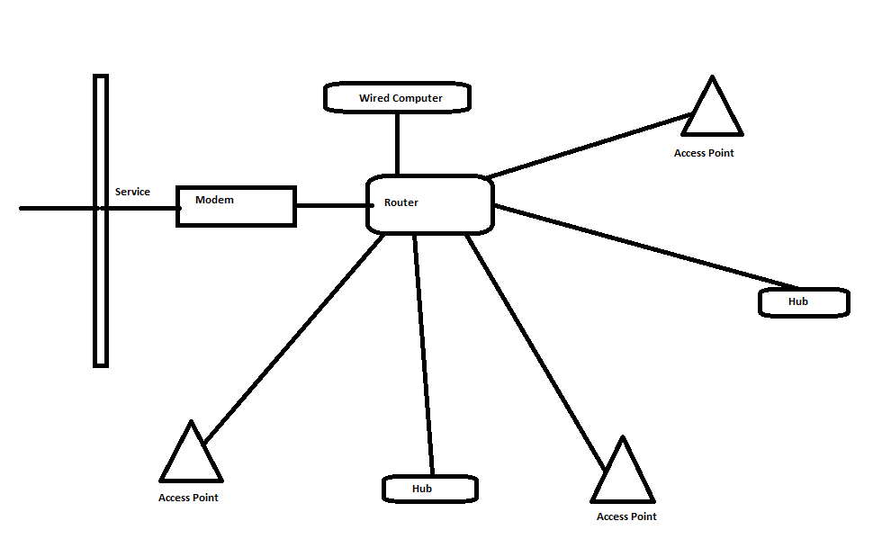

OK kids - Didn't know WTF a mesh router was when I stared reading this thread.  But can one of you smart educated guys tell me what I should do?  Save me time PLEASE!
My need is to get WiFi OCCASIONALLY into my trailer parked in the driveway.  I needed to use it as a covid isolation unit and getting wifi out there was a little bit of a pain but not horrific.  I just have the regular ATT wifi so it's not super strong.  BUT I have a wifi- signal booster antenna/repeater that did the job once I got the antennae situated outside the blocking of distance and garage door (I assume) weakening the signal. I was bought a much longer USB cable that I was going to test by trying to bring the antenna inside my garage a lot closer to the wifi signal and see if that fixes the problem.  My signal in my front yard pops in and out causing me to simply switch off my Wifi when I am trying to work in the yard and listen to pandora or spotify. It would be nice, but not necessary to have a better signal in the front yard and not have to run a hard line to a repeater inside the RV. SO.....
Options -
1) do nothing and use my existing Camp Pro Antennae and repeater with a longer USB for cleaner install when needed to trailer (but spotty wifi in front yard).
2) Get a wifi router that has a stronger signal that can reach front yard better? Have done zero research on cost or distance of signal?
3) go the mesh router route (pun intended). But on cheaper end is it worth it?
4) Buy some other cheaper repeater hooked to my existing ATT wireless? To boost signal to the garage and solve my RV signal needs with existing camp pro antenna and POSSIBLY give me the front yard wifi signal.
Thanks in advance

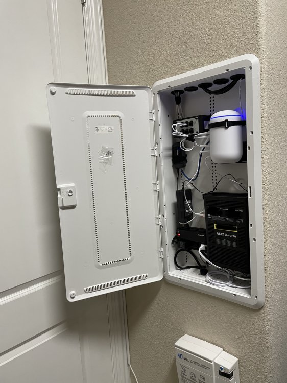

I need to do this to my set up. I have wires everywhere. The builder crap doesn’t actually do anything. Any advice on where to start?
first i took inventory of all the wires we actually used. the little shitty builder enclosure was stuffed with tons of unterminated coax. i did decide to keep them accessible just in case, but i coiled them thru the extra punch downs on the top right. i picked the keystone panel, 1/2 shelves and power supply based on the brand enclosure i went with (legrand/on-q) since i knew they would fit right. i’m sure there’s cheaper ways though.
then i used excel (fuck off) to map everything out so i knew what size enclosure i needed. bought a cheap punch down tool, watched a 2 min youtube video on terminating cat 5e and off i went.

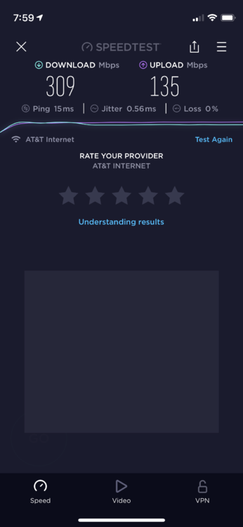

As reported elsewhere, I got the cheap Orbi, dual band with two satellites.
Had it up for a couple of days now and once I got the satellites placed (a bit closer than I had thought), it's rock solid and gives me 60-70% of rated speed if I'm 5Ghz on any of the nodes.
I could get better coverage by spreading the satellites out a little further, but then backhaul drops to 2.4 and speed drops accordingly.
When it's 2.4 connected, either backhaul or to device, the connection is still useful for all but the most demanding stuff, but it's still a bummer.
The key to reliability and speed seems to be a) avoid spacing the satellites so they drop to 2.4Ghz for backhaul.  Which probably means buy more satellites for more coverage, which probably starts to push the cost toward the more expensive systems that can maybe get away with larger spacing.
Thank you for the write up. I have Cat5 running to every room in my house already. I can’t take advantage of it because of the shitty builder closet design. Time to budget and start reading.

nice, I have an On-Q box but the screw on door.  I should upgrade to a hinged door.  Would make life nicer.

I've got Cat5 throughout, but the damn things are a mess, so basically, I've got the modem in the closet, connected to the cat5 I found that runs to the office, and the wireless router then in the office. Would love to map all those wires, but its going to be a pain in the ass since each room has two cat5s running to it, and I guess I would just have to keep running around my house with my laptop plugging in different wires to see which wire runs where.

Yep. This is the answer. I utilize a switch with the eero due to number of access points and it works great.
This is from the corner of my house farthest away from the routers.
On 5/30/2021 at 8:37 AM, Superhero said:
Haven’t had a single drop since last April.
I have a beacon in my garage. Across the street from me is the community pool (yes totally worth it because I don’t have to maintain it).
Sitting the lounge chair about 150’ away from the house, I still have enough signal to type this.
