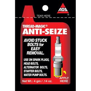

Be sure to throw some anti-seize on the new ones.
Ummmmm, that goes in the raid-ee-a-tor
3
If your doing that throw some dialectic grease in the boots as well. That will keep those from seizing on the plug.
Ps don't get any grease or anti seize on the tip of the plug. Cue the tip dick jokes
