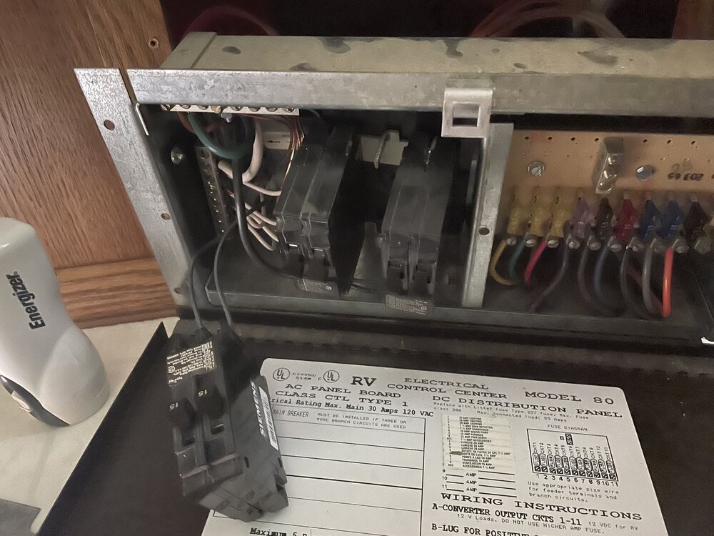

It’s a 15 A breaker that is tripping, correct?  Does everything else work when you turn that breaker off?  What loads are on that breaker?  If it is just 120V receptacles, you might need to pull them and take a look.  Most RV receptacles  are designed for shallow/thin walls and use an insulation displacement type of wire connection vs a screw.  They suck and are very prone to loosen.
ETA:  Kill power to the trailer (and unplug) when you are troubleshooting each receptacle etc, then plug back in to check.
Edited by davidg
#1355
I may be crazy... but do you know that the new service was wired properly?  I would absolutely set up the gennie and see if everything works properly?
I am at IB Magee in Port A this weekend and the power went out twice.  Made me rethink about not using my surge protector/ power testing box.  I didn't want to expose it to too much salt air, but made me think more about surges.  I would be pissed if my shit got fried and I have the tool to save me, in the trailer.
#1357
It sounds like you yave an intermittent ground on the load side of the main trailet breaker. If it was on the source side (your new wiring to the house) then it should case the breaker at the house to trip too. Probably...
If you heard noise behind the panel then I'd focus on that area... I'm no doctor but I'd turn off the breaker at the house and carefully pull out the panel. Look really close for any burn marks or any bare wire or cuts in the insulation.
Before pulling the panel though you could try pulling all the fuses and tripping all the breakers in the panel and then powering up the trailer. If the main still trips then your problem almost has to be between the load side of the main breaker and the rest of the panel. If it doesn't trip then slowly turn on breakers until it does.
As a last resort, with the main panel out, all the fuses pulled and breakers off except the main, have someone turn the house breaker on while you carefully watch for arcs....
Trailer batteries always have some load on them like the car style dvd player and whatnot and will drain down after a coulple days anyway - in my experience.
Good luck!

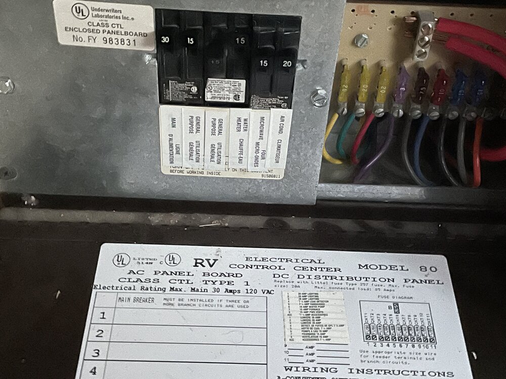

#1358
The one that was tripping was a 15A branch and he replaced it and it still tripped. He has a loose, shorted wire somewhere in that branch. I would check the terminations at the main panel and then pull every outlet and check them. Some where in that circuit is a intermittent short.
Those statements are dependent on everything else working Ok when the bad circuit breaker is turned off.
#1363
I’m befuddled.  Had some time tonight while the guisada cooked down so I went out and messed around some more.
didnt see any issues behind the panel, assuming it’s no big deal for all the ground wires to be bare copper and bunched together.
new fun stuff tonight- I could get the fan blowing with all breakers on the decor the bad one. But if I tried to engage the a/c flip the switch on the water heater, the fan would shut down and not want to come back on. No breakers tripped.
when I engage the faulty 15a it and the 30a main both trip immediately.
either time or cycling the breakers would get it going again but same thing no result each time.
never checked outlets with my cheap multimeter but lights all seem to be running on an almost dead battery set as they are flickering and dim. Sometimes don’t work at all.
anywho, feels like I’m out of my depth here (easy place to get to with electric wiring) so I’ll have a pro investigate, fix, hopefully add the 3 solar panels I have, and maybe educate me a little on how the system works.
pics since I took em.

#1366
The answer to my problem is a faulty converter. All the shore/genny power was deadheading there and overloading.
the apparent intermittency was its death throes.
a 15 minute power outage at the house spurred us to sort the rv out swiftly.
ps used a mobile repair place that we found that services austin. Pretty nice to be able to leave it parked. Trip charge is $65 so not bad.
