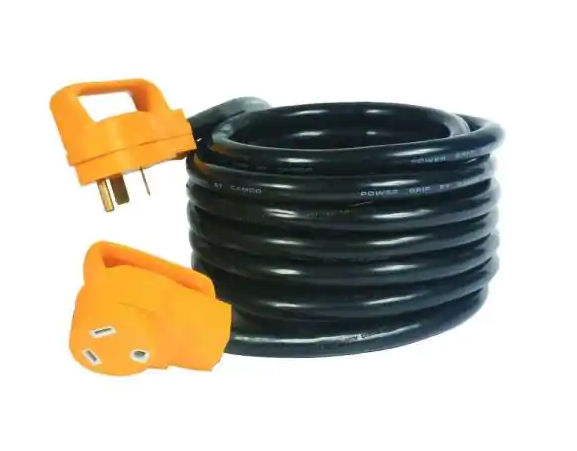

#1653
You can use the adapter and an extension cord from a 15a 120V outlet to charge the battery no problem.    Most 50A rv converters (ac to dc power supply) take about 5-7A of 120VAC.  You can probably run the fridge too off of a 15A outlet. If you have a 20A circuit, you could probably run an air conditioning unit and the convertor at the same time.  The chart below is in my rv owners manual and gives some idea of typical loads.  You can use this to see what all you can run off a regular extension cord.

28 minutes ago, utee94 said:
Really?  Standard RV wiring should charge a travel trailer or 5th wheel RV's "house battery" through the RV's converter whilst plugged into shore power, that's been standard since the 60s at least   It won't charge the starter battery on a motorhome/drivable RV, because that's a separate system altogether.
You should be able to plug it into your home's outlets using a 30A-20A adapter like the one Hawndoh posted.  For just charging batteries or running the RV fridge, it won't draw enough current to endanger the power cord or house circuitry.
If you're trying to run the A/C, then you'd definitely want to use a heavy gauge extension cord and keep an eye on all of the connections.  Arcing can happen where the connecters meet, if they're not adequate for the power being drawn through them.

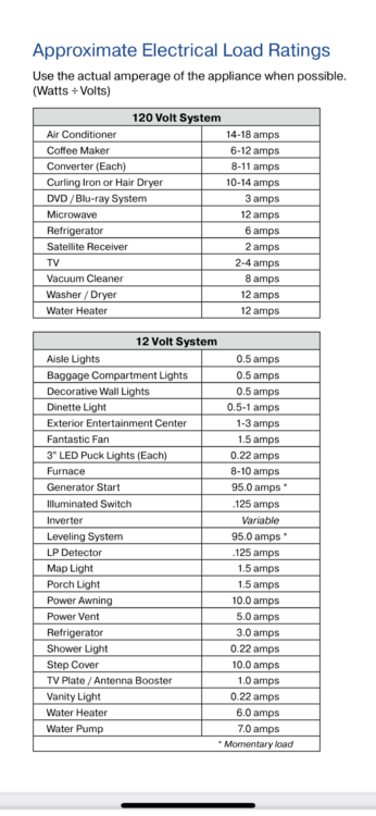

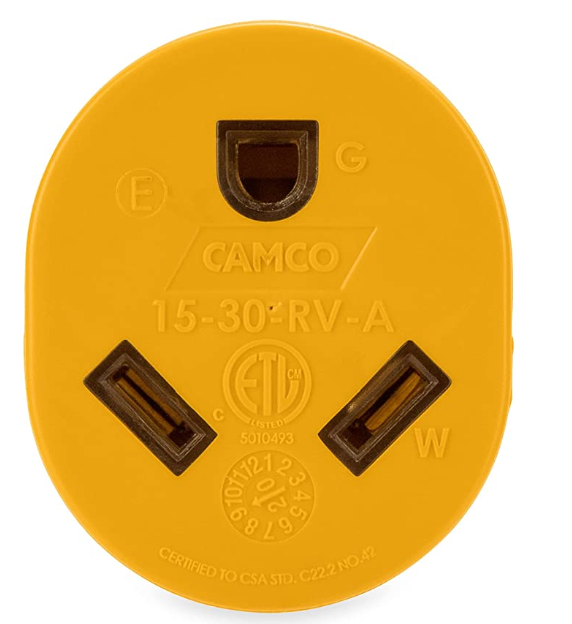

@davidg

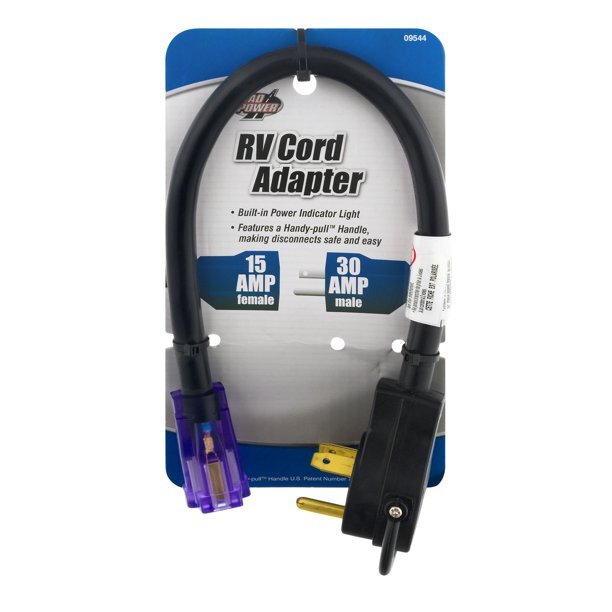

I have an adapter similar to the one below. Would a 14 gauge cord work to charge the battery only?  Not going to run anything while plugged in. Second question, I should turn the main breaker in the RV to the on position so shore power reaches the battery correct? bda36586-529f-457e-aa6e-efeb3c59ae7c_1.62814f550cea6c58691a196487b0ce1b.jpeg.3c58f974ef61d3ffae0b6ae9804f2ae4.jpeg

#1655
You can definitely run the RV's A/C off the 20A house circuit, I do it all the time when prepping/loading the RV at the house.  You just need to be careful and make sure you're using a heavy gauge extension cord, and make sure all the connections are really tight, otherwise they like to arc.  I have a full 30A RV-connector-style extension cord that I run all the way into the wall adapter at the house, like this:

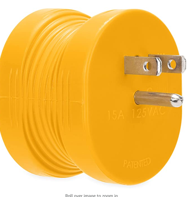

8 hours ago, CoachTex said:
@davidg
14G is fine for charging the battery. You'd want to go heavier gauge for running the A/C.  And yes turn the breaker on to engage the RV's electrical system.
Also, the dogbone pictured above is the opposite of what you need.  That would be used for plugging into an RV-style 30A outlet, like you see at a campsite, and convering it to a standard 15-20A 120AC style house cord.  What you need is an adapter with 15A male and 30A female, so your standard RV male-end power cord can plug into it.
Edited by utee94
#1656
^^^^^^. What he said. You can get one of those adapters at Walmart.
Plug an extension cord into a household 120v outlet, plug that adapter into the extension cord, then plug your regular rv power cord into the adapter.
Forego the regular extension cord if your trailer power cord will reach by itself.
And yes, turn on main rv breaker to allow AC power. Turn off battery isolation switch to allow battery to be charged too (if you have one)
