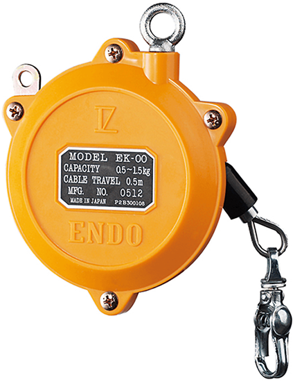

July 8, 20205 yr 2 hours ago, capnamerca said: Ok home DIY and problem solvers, help me out. We got an electric car, and are putting a big charger in the garage. We park the car towards the middle of the garage, so the charger is going on the back wall. I want to swage the power cable across the ceiling so it doesn't drape across the middle of the garage every time we plug in the car. What I want is a way to have the plug readily available near the back of the car, but up out of the way. I'd like to get/find some sort of cable reel, or industrial pulley, or even just a soft spring of some sort, so that the cable lives/stays on the ceiling, but I can just reach up, grab it, pull it down and plug it in. I'd also prefer to NOT spend >$40 or so. I've found the extension cord retractors at HD - that would do the job, but seems like a waste. I looked at lifeline / harnesses for high-wire workers, which would nail the use case but are crazy expensive. I even thought about a portable clothesline, but the retraction springs aren't very strong in those, there more designed for lockout strength so you can hang stuff on the outstretched line. So - any good ideas? Tool balancer - https://www.ergonomicpartners.com/tool-balancers $47

July 8, 20205 yr Author 1 hour ago, washparkhorn said: Tool balancer - https://www.ergonomicpartners.com/tool-balancers $47 Oh damn ... I like this. Thanks! Edit: Dang, the cheap one you linked only has a half-meter of cable. I need ~3 (10' ceilings). Edited July 8, 20205 yr by capnamerca
July 8, 20205 yr https://www.mcmaster.com/spring-balancers/retractors/ 4 feet of travel - $16. or 6.5 feet of travel - (more weight capacity) - $40 https://www.mcmaster.com/spring-balancers/counterbalancers-6/ Edited July 8, 20205 yr by washparkhorn

July 9, 20205 yr Author 1 hour ago, washparkhorn said: https://www.mcmaster.com/spring-balancers/retractors/ 4 feet of travel - $16. or 6.5 feet of travel - (more weight capacity) - $40 https://www.mcmaster.com/spring-balancers/counterbalancers-6/ Respectfully, I think you're misreading that webpage. The second one you posted is ~$230. That said, this is still the winning idea. I'm currently leaning towards this one from amazon - https://www.amazon.com/Reelcraft-TB-05-Tool-Balancer-5-Pound/dp/B002CVTKK6?th=1.

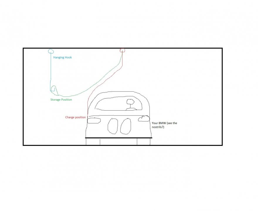

July 9, 20205 yr How about the most basic solution, just a hanging hook for the plug off to the side? See engineering drawing:
