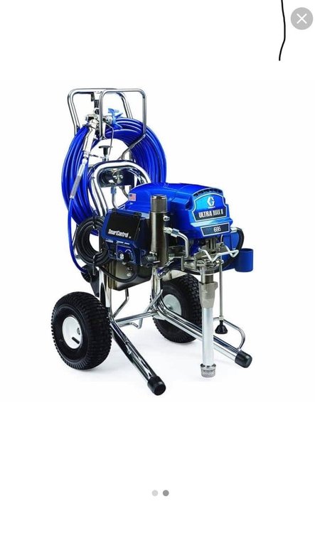

I own an airless, but I wouldn't paint cabinets with it I don't think.
Why not? Isn't that what pros use to paint trim and doors and everything else?
Not really.  They paint walls and ceilings with the airless, and cut the trim in with a brush.
Maybe with remodels? When a house is being built I know for a fact at least some of them spray trim, cabinets, and doors. I can tell the trim and doors in mine were...although they did a shitty job. Ain't no way on hell they're painting that with a brush if they don't have to.
