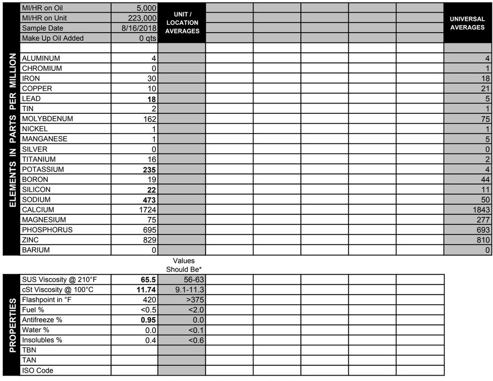

Here is the report from two years ago (~30k miles). I'm sending a sample out today for analysis.
"Unfortunately, this engine has a coolant leak. Coolant shows up as potassium and sodium, and maybe silicon. Silicon could be dirt getting past the air filter or from a harmless sealer or lube too. Make sure the air filter/intake is okay. Iron tracks with oil use and it's fine on a per-mile basis, but lead (and other wear metals) should stay closer to average regardless, so lead shows some extra bearing wear. Universal averages are based on ~5,600 miles of oil use. The thick viscosity is due to Lucas (harmless). Use just 3,000 miles or less and watch for coolant loss."

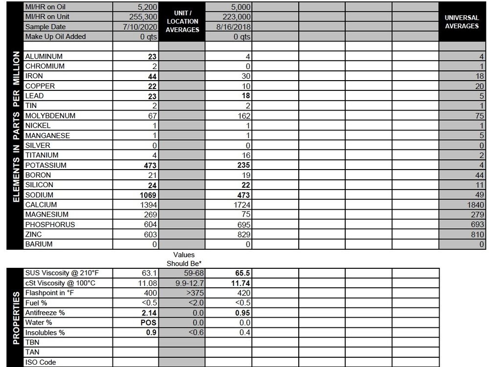

The second oil sample came back from Blackstone
"The coolant leak is progressing. Both potassium and sodium increased, and wear metals have as well. Aluminum and iron are starting to show poor wear at the pistons and steel parts, like the cam/crankshaft or cylinders. The increased copper and lead show more wear from brass and bronze parts like bushings or bearings. This sample tested positive for water, which is likely from the coolant. The contamination is causing the oil to rapidly oxidize, shown in the high insolubles at 0.9%. Keep oil changes to around 2,000 miles to limit wear until the leak can be fixed. Caution."
