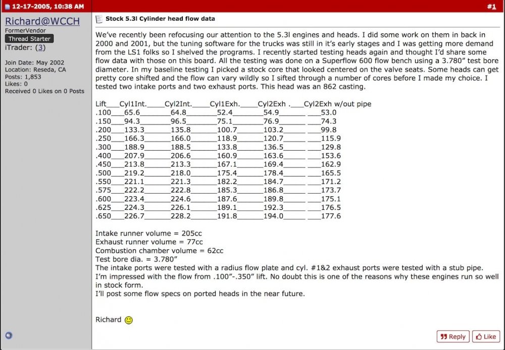

I found the flow data from the stock 5.3 head. If I apply the math, I don't see how I'm going to get ant more HP out of these heads. The engine components seem really well matched.
The stock cam is 0.457in/0.466. Bumping it up to a .500/.500 will only get me about 3hp, unless I do some work on the heads.
The goal here was to capture any easy HP/ gas mileage gains I could by simple tweaks to the engine. I'm beginning to realize they already did that at the factory.
I'm thinking the focus on the rebuild needs to be on porting the exhaust value/ exhaust manifold to increase the flow rate (if possible). After that, spend a few bucks on making sure the parts used aren't chinese crap, and making sure the shop knows what a torque wrench is about. The first challenge with an LM7 seems to be on the exhaust side. I'm not willing to spend much redoing the exhaust right now, so there we have our answer.

As an option, buy a Harbor Freight 6" dual action polisher. Watch a few videos on detailing cars. At least learn to do a basic polish. I use Collinite 845. Polishing oxidation off plastic lenses isn't difficult in the least.
https://www.hotrod.com/articles/chevy-706-ls-heads/
Found this. I'm sure LS6 heads are better, but the stock heads are not bad.

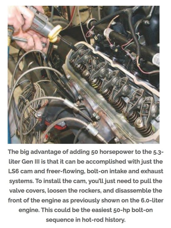

I finally found the answer I was looking for. Someone not only did what I have been asking about, they wrote a book on it. The short answer to my question is "just swap out the LM7 cam with a stock LS6 cam and voila!"
The money quote is:
"The 5.3-liter Gen III Vortec V-8 is probably the most common Gen III engine sold by GM (having been built in a 2:1 ratio to any other Gen III V-8), we have provided a full host of dyno tests adding various components to the base engine. You’ll probably notice there is not a dyno test with LS6 heads bolted to the base 5.3-liter engine. Well, this test was run, but since the engine lost power, it wasn’t included in the rundown.
The reason the engine lost power can probably be traced to the change in compression ratio, as the 5.3-liter heads have 61.1-cc combustion chambers and the LS6 heads have 64-cc chambers. While this might not seem like a lot, it’s enough to eliminate the potential power increase from the larger ports and improved flow of the LS6 heads. Milling the deck surface on the heads, or using the milled GMPP CNC-ported LS6 heads, would probably show a gain, but due to time constraints, that test was not run.
Just looking at how well the LS6 cam did in the 5.3- and 6.0-liter should be enough for most enthusiasts. On both engines, while peak power was slightly raised in the powerband, each engine made about 40 more horsepower just by swapping in the Z06 cam! Add in a few aftermarket components if you wish and the power can be raised another 10 to 20 hp. Not bad for a day’s work."
The web page they wrote about using the LS6 components in a LM7 5.3 can be found here:
https://www.lsenginediy.com/gen-iii-3-ls-vortec-truck-engine-buildup-guide/
I'm going to stick with the 4L60 trans (upgrades to a 6-speed are doable, but not worth it to me). Next time I get ready to do some maintenance on the truck, I will splurge for a set of 1.75" shorty headers. When I rebuild the LM7 engine, I will just swap out the cam and be done with it. Cheap and easy HP with a stock GM part that I will probably find as a leftover from someone who upgraded their LS6. Once the emissions requirement goes away in a couple of years, I will clean up the exhaust downstream from the headers.

Most of the progress I have made on the project has involved defining my wants, needs and expectations for the output of the engine. First, drove to a "proper place" (for me, a feeder street) and from a dead stop, dropped it down into 1st, and romped on it, when I hit what I thought was an aggressive push of the engine, I shifted into 2nd and noted the RPMs. Same for 2nd to 3rd. Winding it out in 3rd had me flying on the freeway, so the 3/4 shift point can be thought out later.
With the RPM info, I googled the dyno chart on the engine and found out how many HP I was drawing from the engine at what I thought was the aggressive end of my driving style. Well, it turns out that number ain't that high. I was flying around at about 3k rpm which is about 200 HP. About as much as a Miata puts out.
So, if the engine is capable of 285HP stock, I need to some more research to learn how tuning might affect the rebuild decisions. Clearly I want power in the lower end of the power band, and I'm willing to give up top end (the engine has never been over 4k in its life). I also want gas mileage for between 2k and 2.5k in 4th gear (70-90 mph with no load).
Upgraded the transmission cooler core to 20,000 (from stock), planning the transmission rebuild to a 4L65E.
On to the tune. Any thoughts/ comments/ suggestions would be appreciated.

The project is progressing. I'm wondering about how tuning might factor into the project. For some time, I have been wondering why our phones and computers need software updates, but not our car ECMs. Well, I found the following that helps any GM car owner check software upgrades that are needed but may not have been applied to your vehicle:
