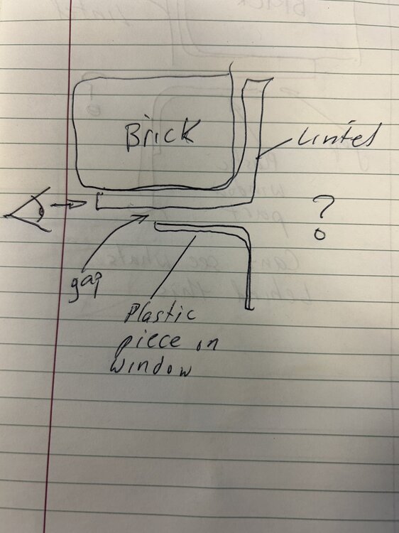

Not exactly a windows question but close.  The steel angle lintel over one of my windows was completely blown out with rust.  It looks like it expanded and cracked the mortar between the bricks above the lintel.  So I found a guy to replace the lintel and re-brick over it.  It looks great except now there’s a 1/4” gap between the bottom of the new lintel and the plastic shroud around the window.  This shroud is pretty flimsy plastic that you can easily move with your finger.  Is this gap a big deal and if so what should be done other than getting the guy back out and ripping it all out?   The other windows on the house don’t have a gap there but appear to have some kind of flexible seal.  Is putting caulk in that gap good enough?
A picture would be nice.
What is  the source of the rust?  Water intrusion?  Are weep holes to allow moisture drainage in place?
Are the windows original equipment or replacement windows?  If original, how old?
Were the window headers hard flashed with a tape seal overlay?
They are replacement windows from before we bought the house.  My guess is they are 10-15 years old.  I didn’t watch the lintel repair so I couldn’t see what was back there.  There were no weep holes.  It appeared the rust started on the exposed edge and ate its way into the flange. The piece they took out looked like it had bites taken out of it in the exposed edge.
Weep holes would be nice.  Caulking that open joint would be OK but also probably not necessary.  The "plastic" thing is most likely a vinyl trim piece for the replacement window assembly.
Any hope for properly flashed windows are long gone as replacement windows typically have the nailing fins removed and are fitted into and shimmed to level and plumb in the rough opening, screwed in to the sides of the rough opening and then caulked where the window frame meets the brick and inside at the drywall  junction.
Use a good caulk such as Sonneborn NP-1 with the best color match (not at The Home Depot) or Sikaflex (usually at The Home Depot but color selection may be limited).  Or you could find the closest ABC Supply (nationwide roofing supplier) and they will have NP-1.
Where are you?
Thanks.
11 minutes ago, deadshank said:
Where are you?
Deep South.  There's no eave on that side of house due to the design, and it experiences rain, direct sun, and high humidity 24/7/365.  Some of the other ones are starting to rust too but much more slowly.
42 minutes ago, ClubWhatever said:
Thanks.
Grind off the rust, apply metal primer, apply metal paint.

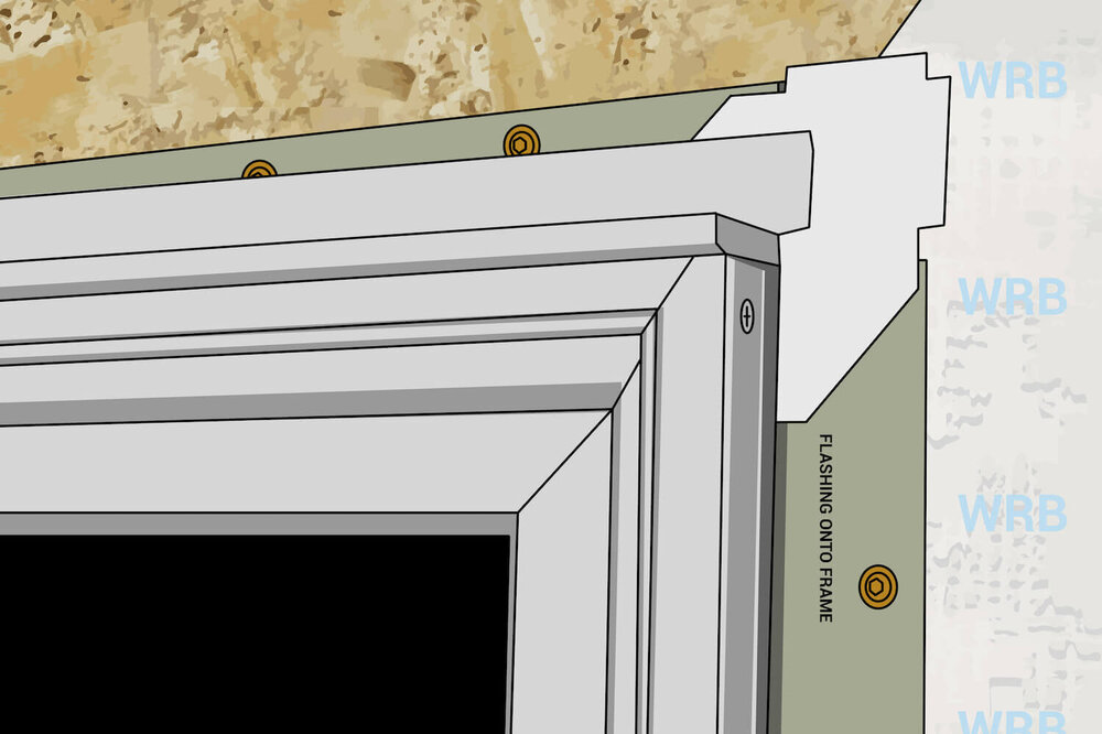

Can someone give me a tutorial, or a vid link, to the proper way to flash a window/door. Emphasis on "proper way".
I’m your guy.  We flash over a thousand a year.
This is pretty close to the way we do it.  The one thing they do that I don't like is the piece of metal header flashing that goes on at the top of the window toward the end of the video.  That piece of flashing needs to turn 1.0" down the left and right side of the window.  It needs to be back-taped, as well.
If you are using the ZIP sheathing system the ZIP tape MUST be used.  Other flashing tapes won't adhere to the ZIP system.  ZIP tape ALWAYS has to be pressed in with a roller.
If you are using regular plywood or OSB sheathing then Protecto Wrap can be used.
2 hours ago, Not that Bob said:
Well, I'm behind the times. When I think flashing I think sheet metal.
Still need metal at the window tops.  Tape at bottom and sides.
Some instances will require sill pans.
