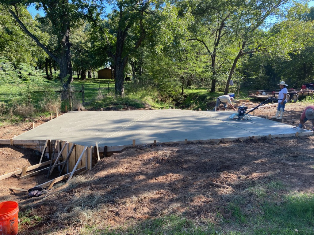

Jose, Anulfo, and Paco poured the culvert today. I used FRC at 3500 psi, rebar in the 45 degree corners. Looks great. Jose has been around here for 35 years, he can do concrete, erect metal buildings, build fence, and  can roof as well. The guy can do anything. I loaded him up with firewood. and he is coming back later in the fall to pick up pecans.
