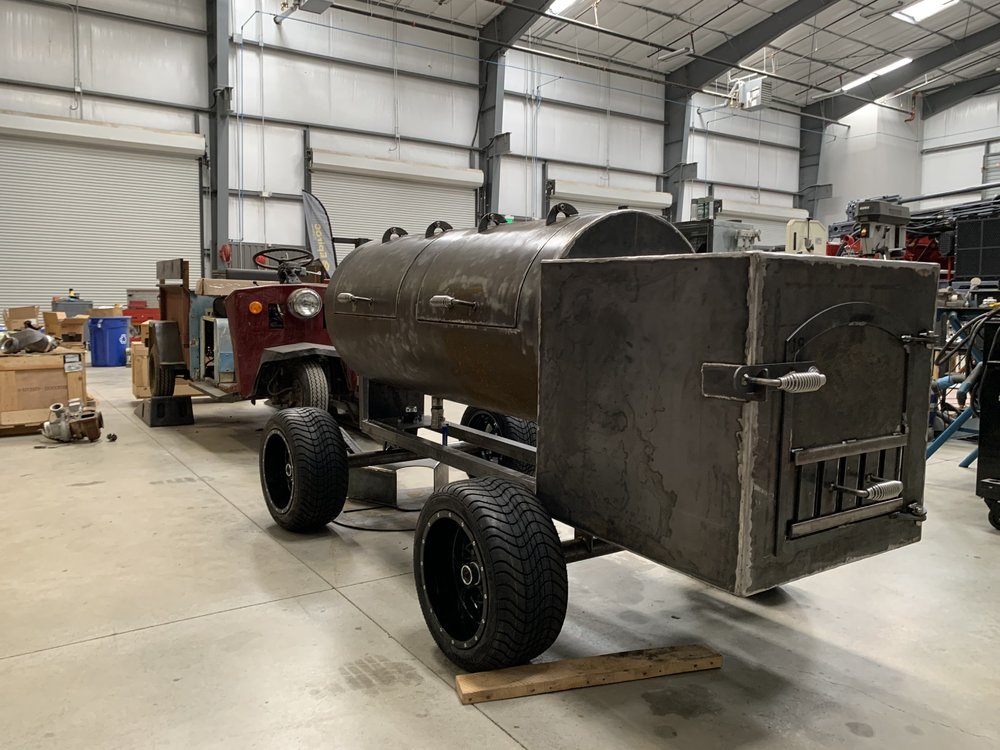

Working on this beast with some buddies. 26x60 with a double wall insulated firebox. Goal is to have it ready to go by the 4th.
Plan is to clear coat it with that unfinished look.
Needs bigger tires.
Those wheels and tires need to go with a more finished look, IMO
To each their own. I personally like the contrast.
2 hours ago, hornian said:
Needs bigger tires.
Will 37s fit without a lift?
Valentina's has had a clear coated smoker on display out front for a few months.  It looks great.
Nice fucking pit. I'd go all murdered out myself, but a clear coat would also be nice and unique.
This^ or maybe a high gloss grey.
Also, you doing tuning plates or anything inside?
Maybe some fuzzy dice in the mirror?
11 hours ago, hornian said:
Needs bigger tires.
That is bad ass.  Send more detail pics when you get a chance.  One question:  Is that handle for the firebox baffle supposed to be on the inside?  Seems like that door is reversed.
Optical illusion.  I thought the same at first glance, but the door is actually mounted on the right (closest to the camera) upon further inspection.
Ahhhh.  Yep.  I stand corrected.
Spinner rims would be a nice touch.
If he’s in Houston it needs to be Swangas with some shit written in neon on the back.
Keeps people from messing with the fire once it gets hot!!!!
IMG_3213.thumb.JPG.5cf87947fabf026f747655e270b1ee87.JPGH
Here is another shot that shows the front side. You can see how the door is connected well in this one. On to your comments and questions.
Regarding the wheels, this pit will be shared across a few people in my neighborhood. While I am the majority investor in the hard costs, there are others contributing in significant ways (e.g., labor, materials, shop access, etc.) and we will all be using it over the coming years. The golf cart wheels make it super easy to transport around the neighborhood.
As for the interior, no plans for tuning plates. there is a heat deflector between the fire box and the smoking chamber that is angled up. There will be an upper shelf on the left side door. Otherwise, we don't have anything special planned on the interior.
We are at the finish line, and just need to finish out the cooking grates, connect the smoke stack, install the stainless steel shelf, finish wire brushing, and then it'll be time to put the clear coat on. It's been a fun project.
If anyone is curious, we bought all of the raw materials from Big Phil outside of Rockwall. Dude was really cool and has been helpful throughout the build process when we have had questions.

I would be nervous about the firebox melting the tires.  How big is the gap?
This.  My first offset I stored wood too close to the firebox and a couple of logs caught fire.  Unattended, that could have been a disaster.
That firebox is a double wall insulated firebox with two layers of 1/4" steel sandwiching a thick layer of mineral wool insulation. That's not to say that it won't be warm to the touch, but it should not be near hot enough to pose any threat to those tires.

@RichUT:  you're probably gonna hate that firebox door.  it looks cool AF, but if there's one thing I'd do different on mine it'd be to make a bigger door.  or think about some kinda handheld chute you can poke in there to feed it.
I gotta rig up some outriggers to jack mine up to keep the tires off the ground for longterm storage.
