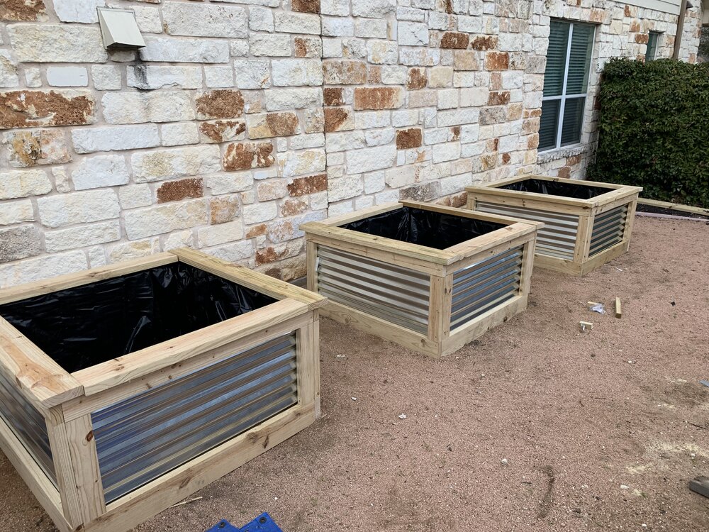

Indeed my man, times two: first day I triple measured everything, consulted my plans twice every cut, used scrap wood clamped down as a guide for the circ saw on the plywood, pulled out the square before drilling pilot holes critical to alignment, googled how best to address small splits on the ends of my 2x6’s, agonized over where best to use each fastener, damn near tried to account for gravitational waves to ensure I kept the bubble on one of my drills dead centered...and it still came out looking like a sad facsimile (to me, at least) of the pro that wrote the instructions.
Today, day 2, I just powered through the second and third beds in a way that’d make Henry Ford blush.  Had that miter saw bumping for an hour, plans memorized, slowed down only by foolishly losing my black hex bits in the dark dirt...and all three ended up about the same when it comes to precision.
Two 8-hour days with no lunch, pissing in the bushes and covered in saw dust while being sore in places I didn’t know had muscles...but for someone that lives behind a desk, was a great experience.  Wife loves them, and that’s good enough for me.  No bad cuts either, my scrap pile was minuscule.
That link I went off was pretty crappy, in respect that I had to solve a lot of little problems myself...reminds me of homers foundation repair experience ‘now parge the lath’ in that it was all ‘assemble the frame, then install the plywood backing’ with no real hints on where to put the fasteners or how to keep the cleats from splitting or how to keep things square or how to install that fucking awful 6” deck screw straight or the best way hold the frame steady while assemble it or...
Sadly ended up 16 deck screws short, so will secure the top trim tomorrow...hence the goofy look.  But here’s the final product:
Edited by Homercles

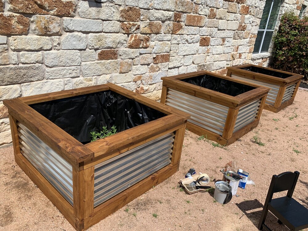

Great job @Homercles
You forgot to tell us how good that beer tasted when you got done and you sat in front of your masterpiece with the sun going down.
The payoff was worth the effort.
Heck yeah man, I think I’d have enjoyed it more if I wasn’t trying to squeeze it all into a pair of 7 hour days due to work considerations.  Proud I was able to do it as that was well outside my experience level and as noted above the plans were incredibly general, requiring me to improvise...so lots of little triumphs in there.  Friend of mine o rarely see seems serious about a few of us getting together to build them, could do it in my sleep now and it’d be a good excuse to spend a day hanging outside.
Hugely appreciate the practical advice you gave in this thread!

Finally stained the bastards.  3.5 hours. Just need dirt now.
Either you are a little bitty feller that uses a leprechaun's chair to sit in or those planters are really big.
Nice work. Didn't even ripple the metal panels.
