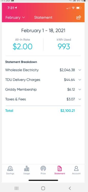

So what's up with this energy spot price? I am on CPS, so it looks like they have some kind of variable model, but there is no way they expect middle class families to manage a several thousand dollar electric bill, right? This appears to be ERCOT's massive mistake, so no way should Texas citizens have to pay the bulk of it out of their pocket directly.
So you're saying I should turnoff auto bill pay?
Buddy of mine sent me this...he uses Griddy.  That membership is really paying off!
