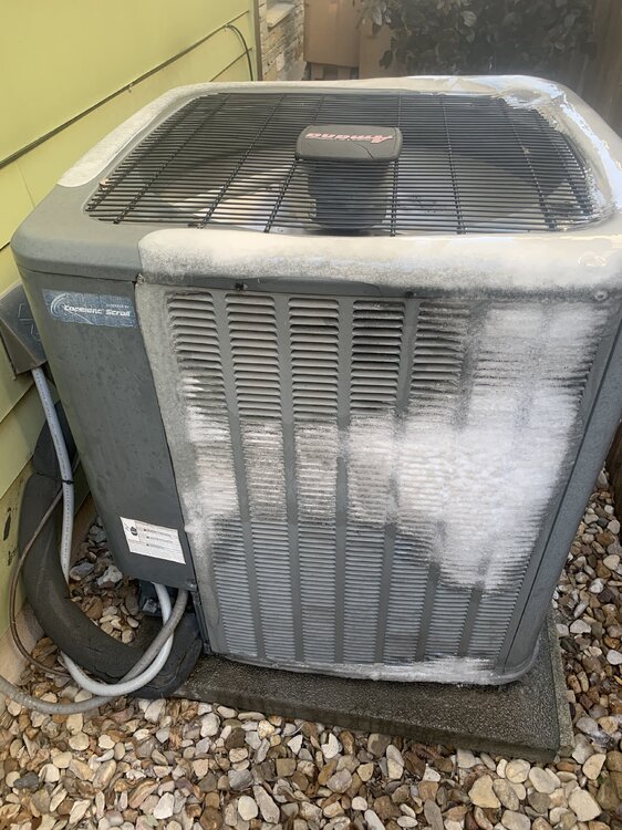

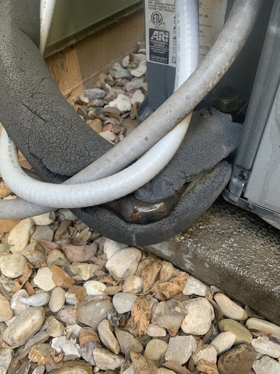

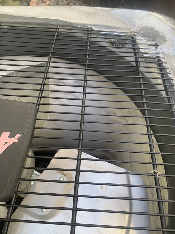

I’m a bit freaked out about my AC unit. It’s on the north side of the house in pretty much constant shade and it’s completely iced over. Inside and out. There’s an insulated pipe, which I assume runs water when the AC runs, but there’s about a 6 inch section where the insulation is ripped and the pipe is exposed. Will I just have to wait until it’s time to run the AC in a few weeks to find out if it’s fucked?
As I was taking these pics, the fan kicked on, so I guess that part still works.
First of all, definitely do not run the fan if it's frozen.
That copper tube it what carries your coolant, not water, and they aren't worry to burst since its freon or R-22 running through them. Just let it thaw out on its own which shouldnt be an issue since running your AC wouldnt be necessary anyway right now. Those things are fine with cold weather even if they freeze a bit.
Thanks. I mean, the fan is running because of the heater right?  So presumably it’s been running this whole time?
The thing I would worry about is your defrost sensor might be shot. It's supposed to detect that the line is frozen and go into defrost mode. When mine does that, the fan doesn't spin and the compressor runs, which heats up everything until you're thawed out, then goes back into heat pump mode. Then it flushes the whole system out, cooling it, and start the process over from scratch. It gets real hot in defrost mode. During the freeze, mine would billow steam and I could see water evaporating right off of the compressor.
You might want to pop open the blower and see if the coils are frozen in the house. If so, then you might have a problem. If it's just frozen outside, you might be okay. Either way, getting a tech out might be difficult. If the coils are frozen inside, shut the outside down by turning the system off, but keep the fan on to aid in defrosting the inside coils. You might be able to save the compressor if it is just a sensor or the switch shorted out and welded itself into the on position.
Edit to clarify: keep the inside fan on, be sure to turn off the breaker before opening up the blower inside.
No the fan and heat pump are independent of each other. Heat pump runs air from the vents like your AC but doesn't need to cycle out warm air or cycle in coolant. So the fan shouldn't technically run when using just heat.
Small amount of clarification in a single post.  That is your "compressor" or "condensor" unit.  The only fluid flowing in and out of that enclosure is "freon."  The fan at the top keeps air moving around the compressor below it, which generates a lot of heat when it's operating.
That unit receives vapor/gaseous freon from your air handler, compresses it into liquid and sends it back.  In the coil portion of your air handler, the compressed freon is expanded back into gas, which flows through the coil and cools the air and the previous cycle repeats.
Your air handler has a fan or blower.  That is what moves air around your house, not the fan on the compressor.  Your air handler also includes the previously mentioned coil, which is used for cooling, and a furnance (gas burners) or heating element (if electric).  If your ac is on, the coil is active and the furnace dormant.  If your heat is on, vice-versal  The blower blows the air over whichever is active and circulates the heated/cooled air using your ducts to your vents.
What fan are you talking about? The fan in the furnace or the fan in the condensing unit (the metal box you took a picture of)?
First, take a shot/xanax/toke/relaxer of choice and chill. The outside unit does not have a water drain. What you are seeing is just winter storm accumulation. The inside unit is what produces condensation. You are good to go once everything melts.
Condensing unit.
It’s fun and embarrassing to realize how little I know about household shit thru this past week.
4 minutes ago, Biff Tannen said:
Condensing unit.
Keep an eye/ear on the fan. We were out playing in the snow with our three year old a few days ago and noticed our elderly neighbor's unit was completely encased and had accumulated enough ice inside the unit to block the fan blades from spinning. It wasn't happy. I cleared all the ice off and out of the unit and unblocked the fan blade for him, and it resumed normal operation immediately, but if we hadn't been out playing on that particular side of the house, we'd have never noticed it.
You’re fine. When i lived up north mine was under a mound of snow about 1/4th of the year. Just dont start it until everything melts.
I suppose I should caveat by saying this is how standard air conditioning works.  Unless for some reason you turned on cool and your thermostat malfunctioned, there is absolutely no reason for your compressor or its fan to be running in these conditions.
If your ac is a "heat pump," thing work a little differently and I have no direct experience with them.
