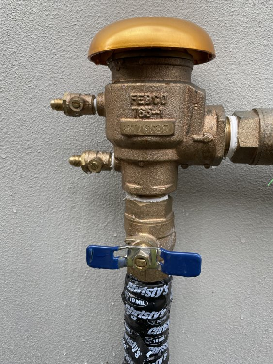

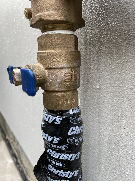

5 minutes ago, Enchubben said:
Should/can I try to fix thus myself or just call a plumber/irrigation guy? Part impossible to find?
What does it feed below?  And how easy is it to connect/disconnect below?
Based on your comments about calling an irrigation guy, it sound like it feeds your irrigation system.  If so, I'd consider capping and solving later.
However, you might be forced to do what available parts allow you to do.  I was in HD and Lowes yesterday (78750) and they are entirely picked over for caps.  Some have ball valves; some don't.
#1405
The pipe goes into the ground, it’s the water supply to sprinklers. The bell/assembly looks fine above it and with that valve closed, no issue with leaking so far.
#1406
I’ve now seen this a few times. What is this? I mean I know thru the comments it’s for irrigation but what’s it called. I’ve had several homes with irrigation and never seen this. Building a home now and working in some stuff I learned this week.
Backflow preventer.  Kind of a recent code requirement of environmental origin.
#1410
Good that it does not leak when closed.
How it is connected below (under the wrap) is what will dictate the complexity of a DIY fix.  Looks like a common threaded ball valve at the top, but it does not show how it is connected below.  In my experience, *Most* irrigation repair is easy to DIY, esp. the above-ground stuff.
If you are not comfortable w/ that kind of thing, ask your irrigation guy to fix.  He likely has parts and will be more affordable than a plumber (IMO).  You'll be lower on his list, as water is not pouring out of your system.

9 minutes ago, luke duke said:
You may want to order one now. They’re probably going to be in short supply for a while.
I’d fix it myself if you can isolate water flow and unthread the valve.
This. That’s an extra closet in the hallway, which has value.
When you say isolate the water flow, I’m assuming you mean turn the water main off at the street right? I don’t know that there is another place to do that.
Rule of thumb for me is if I feel comfortable, I do it myself.
But if that's not the case here, it'd be a few hundred bucks for a sprinkler guy to fix the backflow preventer.
And that’s exactly what I’ve been quoted; 200.  I probably would do it myself but I made two stops to find parts with no luck.  Probably worth it to just have them replace the whole assembly.

Was able to cap off the busted pipe outside and turned the water line back on a few hours ago. Good pressure and all faucets running. Checking for leaks and don't see/hear any. I think I'm in the clear. Really lucky to get out of this with no busted pipes. Hope everyone is doing ok.
