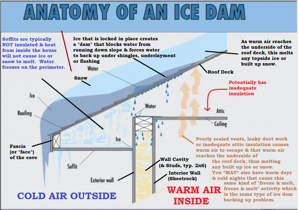

& YES, DeadShank was partially incorrect when he said it isn't possibly a flashing thing.  Ice dams CAN force water to slip backwards & under flashing
If a metal roof, you can get condensation forming under the panels due to an ice dam & if at a pitch change location, that will cause some melting action.  I have 2 houses out here in Dripping Springs that have done the same thing... I suggested they use a paint stripping type heat gun to excessively melt the snow or ice from inside & totally remove the dam that causes a backup of water.  Worked on both occasions.
