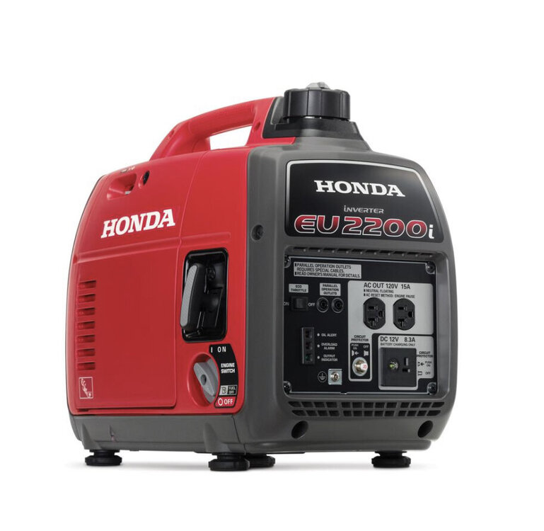

FYI on the Honda EU2200i:
They run like shit in temps below 20 above zero unless you get the cold weather conversion kit.  I had an old Honda 2000 and that thing ran like a champ at any temp.  The new 2200's are over engineered.  The carbon monoxide detector is overly sensitive and will shut the generator down unless it is very well ventilated.  Like in the open ventilated, not even under an overhang or up close to a side wall unless there is a good breeze.
