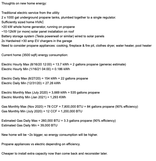

February 19, 20214 yr 5 minutes ago, crimsonlonghorn said: This what Mrs CL and I are discussing this morning to add to our house plans. Solar panels and the backup generator are probably redundant, but I'd rather spend money up front than not in case the weather prevents the solar panels from working right. Only problem is that the back of the house with the best real estate for solar panels will face NE which is the worst direction to point the panels. We probably won't get as much from the panels as we would hope. We probably don't want to put the panels on the front of the house because of the angles and aesthetics. We were on vacation for a whole week last August, which is why July was the highest month without having the highest day or hour. Someone check my math. I have no idea if this is right or not, but it seems to be in the right order of magnitude. Balla. But I think the generator + solar/powerwall combo is probably a bit too complicated to be worthwhile. For that size house you'd likely need 40kw generator to account for peak loads (e.g., air conditioners/heaters starting). And integrating both powerwalls and a generator to work well together is going to be a pain. Personally, I'd go all in on one or the other. And, if you want your solar array to really contribute, you're easily looking at 20+ kw system to get a substantial benefit for that size house. Otherwise, you're really just generating like 20% of your needs, so what is the point?
February 19, 20214 yr 2 minutes ago, TXSG8R said: Are you going from like to like WRT insulation, efficiency of appliances/HVAC, etc? Makes a big difference. My previous house was 1600sq ft and had a 4 ton AC unit probably 14 or 16 SEER that ran all day during the summer, two story blown insulation. My new house is 3k sq ft and has a 4 ton AC 20 SEER that usually runs in first stage, easily half the usage of my previous house. The new house is single story, sealed envelope spray foam. It can throw a lot of your numbers way off. Yeah, the current house is 30 years old with batt insulation and older appliances. Architect and builder are still discussing insulation needs in the new one (i.e. blown vs foam), but either way it will be more efficient and modernly constructed with modern appliances, so the per foot energy consumption should be lower. How much lower, I don't know, but the increase in overall size should still cause some level of increase in overall consumption. I can't see it going down, but it's definitely not going to double, either.

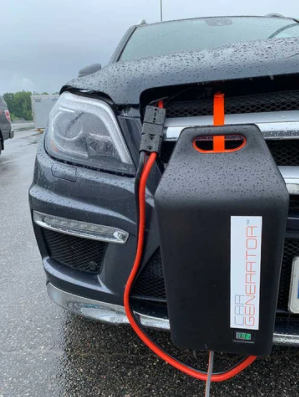

February 19, 20214 yr 1 hour ago, fuggled said: If it's just for emergencies: https://www.cargenerator.com/ that's really interesting. the 1 kW is $695 CAD right now which is like $550 USD. you can get a similar inverter generator for $300 so if you get this instead you're basically paying $250 for the ease of not having to deal with maintenance and gas/propane/NG input. worth it?
February 19, 20214 yr 4 minutes ago, crimsonlonghorn said: Yeah, the current house is 30 years old with batt insulation and older appliances. Architect and builder are still discussing insulation needs in the new one (i.e. blown vs foam), but either way it will be more efficient and modernly constructed with modern appliances, so the per foot energy consumption should be lower. How much lower, I don't know, but the increase in overall size should still cause some level of increase in overall consumption. I can't see it going down, but it's definitely not going to double, either. If your architect and builder are advocating for anything less than spray foam get a new architect and builder. You can absolutely reduce your electrical usage in a bigger home with just that. You need roughly half the HVAC capacity alone due to the insulation gain.
February 19, 20214 yr 4 minutes ago, gsoda3 said: that's really interesting. the 1 kW is $695 CAD right now which is like $550 USD. you can get a similar inverter generator for $300 so if you get this instead you're basically paying $250 for the ease of not having to deal with maintenance and gas/propane/NG input. worth it? I question the long-term impacts this has on a car engine - idling for 10+ hours can't be ideal, no?
February 19, 20214 yr 6 minutes ago, The Ace of Aces said: I question the long-term impacts this has on a car engine - idling for 10+ hours can't be ideal, no? On the dedicated setups, like the F150, I'm sure the electrical load acts like a mechanical load and raises engine speed from idle, which would be very helpful to engine life. On those add-on things, I'm not sure that would happen, and the engine would stay at idle and yes, that is not a good idea.

February 19, 20214 yr 11 minutes ago, The Ace of Aces said: I question the long-term impacts this has on a car engine - idling for 10+ hours can't be ideal, no? yeah that's a good point. could be why the f150 only has their power port on hybrids and it might work like how Twice suggested.
February 19, 20214 yr 5 minutes ago, gsoda3 said: yeah that's a good point. could be why the f150 only has their power port on hybrids and it might work like how Twice suggested. I don't think that is bad for a modern car, though it is not ideal. Probably going to wear out the alternator though. edit: my limited experience with inverters is they don't rate what they say they will. Most cars today are going to have 140 amp or so alternators, so do your math conservatively (maybe you can get 100 amps out of your car then?). Edited February 19, 20214 yr by GringoSalado

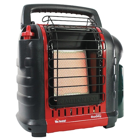

February 19, 20214 yr Lots of bottled water plus this little propane indoor heater, plenty of little propane tanks, and extra CO detector. T That's really it. We'll get enough dry food to get by. I just don't want to freeze.

February 19, 20214 yr 1 hour ago, The Ace of Aces said: I question the long-term impacts this has on a car engine - idling for 10+ hours can't be ideal, no? Serious question...why? Ambulances and police cars idle all the time, don't they? This feels like something that may just be a myth.
February 19, 20214 yr Propane space heater, propane camp stove, extra propane, candles, canned food and an assortment of backpacker meals, stored water (jerry cans, aquatainer jugs, 55 gallon drum...), deck of cards, wine and beer, more firewood, hand held coffee grinder. A generator of any sort would come well behind all that other stuff for me. Couldn't give 2 shits about lights, TV, internet, etc.. The only critical thing a generator would be good for is powering fans or swampcoolers in the heat, and if it's a heat event then the roads are likely passable to GTFO of dodge and head north.
February 19, 20214 yr 6 minutes ago, fuggled said: Serious question...why? Ambulances and police cars idle all the time, don't they? This feels like something that may just be a myth. Ambulances usually have a diesel engine and/or generator and cop cars have 2 alternators and heavy duty wiring.

February 19, 20214 yr 13 minutes ago, fuggled said: Serious question...why? Ambulances and police cars idle all the time, don't they? This feels like something that may just be a myth. Don't know if this is still the case but a while back I had an "imcomplete" 2003 f350 that was amberlamps spec and it had a high idle feature that kicked in after a few seconds. But any computer managed cars these days can probably handle it. My understanding is that at idle damage can occur because engine is not up to temp and oil pressure is too low, and I would think any modern car's ECU manages those things sufficiently.
