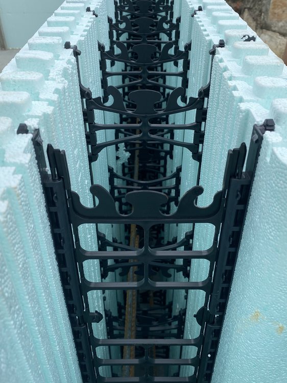

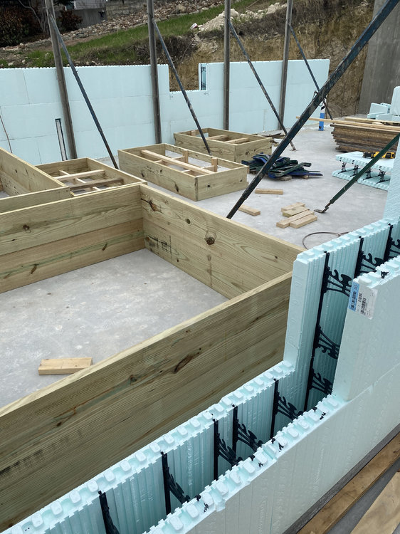

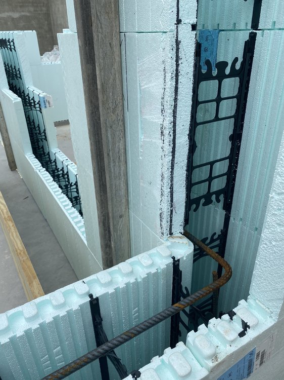

15 minutes ago, troph said:
Zombie fortress under way...
What am I looking at?
(am out of the loop on most of these threads)
I'm impressed Troph. Filling with concrete?
Those are the forms for insulated concrete forms for the outer walls Troph’s house. (Concrete is poured into the gap. Insulation remains on both sides for R value). Done that way instead of using typical 2x6.
Ah, newfangled construction technology!
Wonder how much it would increase the cost of a home if all the exterior walls up to the eaves were constructed like that instead of balloon frame?
I think most estimate it as about 5% cost of house, as opposed to closer to 2% for traditional framing. But you should get substantial saving on energy usage to offset much or all of those costs long term.
That's the new fancy way to build basements up north.  I've seen it on some building shows before.
There were waiting lists for Generacs before this happened.  They have been having supply issues since covid started.  Kohler is a really good alternative.  I have an engineer cousin who got one a few months ago.  He did quite a bit of research and thinks the Kohler ones are a little better because of something that is different with their windings compared to a Generac.  It's over my head, but he's super smart so I'll take his word on it.
ICF for the win.  Your house will be tighter than a nun's pussy with regard to air exchange.  Downside: if you ever need to get into the walls for any reason, that won't be as fun.  This is the walkout basement?  How high up are you doing ICF?  Are you putting in an ERV or any kind of in/outside air exchanger to make the house "breathe?"
the concrete is sandwiched between the blue insulation?  how are they going to attach drywall?  and if you ever want to add plumbing to an exterior wall do you have to break the concrete?
Pic doesn't show it well, but you just hit the plastic ties with the drywall screws. The ties are designed for it.
Re: plumbing. The interior foam is +/- 2" thick, so there's room for your regular water lines. Sewer needs to be cast in, or run through an interior wall, which is better anyway. (Did you learn nothing from the Apocalypse?) New penetrations for new exterior faucets? Get you a hammer drill. It's a downside of ICF.d3d2e6b1be2910ed330e752af1073c9d.jpg
