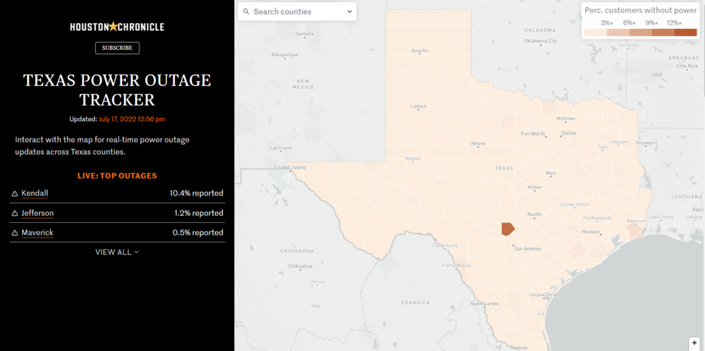

3 hours ago, utee94 said:
Doesn't look like a state issue, should probably check with your local power company.
I guess I was just lucky.
It was back on in less than an hour.

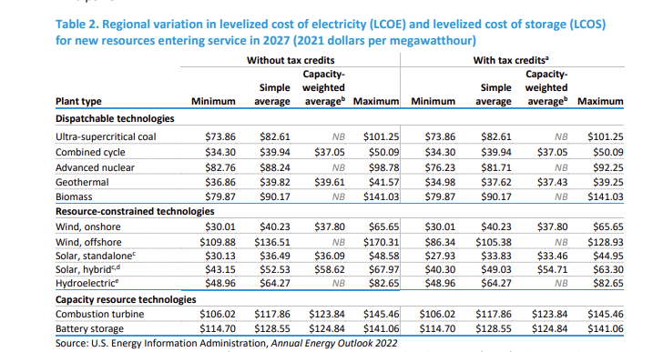

On 6/16/2022 at 11:50 AM, Dahobbs said:
I've posted this many times, but I'll do it again:
Based on LCOE in the United States, with or without renewable subsidies (but including all indirect subsidies for fossil fuels), solar is significantly cheaper than fossil fuels. Onshore wind is roughly even with combined cycle and cheaper than other fossil fuel options. Of course, this is a March 2022 report and doesn't include recent price hikes in natural gas. I do note that the addition of storage will drive solar to be higher than combined cycle in this estimate. However, storage is largely unnecessary until reaching higher percentages of renewables on the grid (and there are plenty of studies on that if you need cites). Notably, battery storage systems are quickly reaching price parity with combustion turbines, which is a pretty big deal since they largely serve the same purpose in the grid.
https://www.eia.gov/outlooks/aeo/pdf/electricity_generation.pdf
Keep in mind, the EIA estimates for new renewable generation have been notoriously low-balled, with actual generation doing better than these predictions pretty much every year. There is a reason that something like 80% of new planned capacity in Texas is renewable (mainly solar), and you see a similar pattern nationally. It is economics.
I have no idea what that means. Plenty of countries have renewables generating a majority of their power. But there are certain things gas is better at right now and it needs to stay in the mix (particular as a capacity resource technology as defined above for combustion turbines).
As to your last sentence, again, there is a reason that something like 80% of new planned capacity in Texas is renewable (mainly solar), and you see a similar pattern nationally. It is economics.
On 6/16/2022 at 12:46 PM, Dahobbs said:
Using renewables as feedstock? I'm talking about the cost to generate electricity. But, I see you're a ignore reality type of guy. Whatever floats your boat. Renewables are more economical right now and that isn't changing.
But, you don't have to take my word for it. I gave you the numbers above. But, you could also ask Deloitte (https://www2.deloitte.com/us/en/insights/industry/power-and-utilities/us-renewable-energy-transition.html😞
Or you could just look at what companies are actually investing in and what new capacity is planned. The answer is renewables:
https://www.eia.gov/todayinenergy/detail.php?id=50818
https://www.spglobal.com/commodityinsights/en/market-insights/latest-news/natural-gas/122821-commodities-2022-most-new-us-generating-capacity-will-be-solar-followed-by-wind
https://electrek.co/2022/03/07/solar-and-battery-storage-make-up-60-of-planned-new-us-electric-generation-capacity/
Or, we could ignore that information and assume that all the companies actually building new capacity are acting irrationally since gas is a much better investment. You tell me what is more likely.
On 6/16/2022 at 2:05 PM, Dahobbs said:
Yes, oil and gas is a bigger industry right now. I don't think anyone debates that. And in terms of total dollars returned, oil and gas has returned more money to investors. I don't think any debates that. It is after all the older, more established industry. But, if the question is where should  a power generating company invest its funds (I'm not talking about anything else oil and gas does like petrochemicals or even gas for cars, just power generation),  then the answer is going to be renewables. They just have a better bang for your buck right now in that particular space. That's what the economics says. And that is why 80% of new generation coming online this year and for the foreseeable future is going to be renewable.
As to your criticism of my stock selection, I chose some of the bigger players in the renewable space. It is a growing sector, not an established one with large entrenched players.
On 6/17/2022 at 6:09 AM, Dahobbs said:
The LCOE information was linked on the same page as your post. I've quoted it again below. Utility scale solar LCOE without subsidies, is $36.09 per mWh, combined cycle is $37.05.  I also provided links regarding actual capacity being built and analysis from Deloitte. It all has the same conclusion: solar is cheaper than gas. I don't know what banks and private equity your dealing with (or to what end). But apparently it's not the ones actually funding the build out of new capacity, the vast majority of which is renewables.
As to my person system, rooftop residential solar has a completely different cost profile and is a lot more expensive per mWh. But it isn't really relevant to this thread when we are talking about power plants. My personal system was more like 20k for a 30k system after tax credits. No subsidies would drag the payback period to around 15 years. Still doable, but definitely less financially attractive. Again, not really relevant to what we are talking about.
Here ya go @Porterhouse. I requoted our extensive discussion on this topic, along with the sources. Renewables are cheaper and are the vast majority of new electric generation development. Deal with it.
oh, and here is the source for fossil fuels being only 60% grid since you refuse to believe that as well. https://www.eia.gov/tools/faqs/faq.php?id=427&t=3

49 minutes ago, Dahobbs said:
I've given you the data before from multiple sources, including the department of energy and major accounting firms. I don't know why you refuse to believe the actual numbers. and I don't know why you refuse to recognize that the reason new developments are mostly renewable is because of the better economics. Renewables are cheaper as an addition to the grid. They get more expensive as they become a higher percentage of the grid due to the need for over capacity, interconnects, storage, and/or peaker plants.
Gas isn't going to get to 80% of the grid. That's just not realistic when all fossil fuels combined are 60% right now.

Batteries are already near price-parity with gas turbine peakers. I'm not sure why you're acting like this is a completely unsolved problem. It is technically doable and being implemented in mass now. Yes, we need prices to keep going down and we'll need adjustments to manage fire risks (and those lessons are being learned an implemented quickly). But, fundamentally, we know how to do this. Like anything, it costs money.
I'm also not sure why you think a high level of renewable electric energy generation isn't possible. A good number of countries are above 80%, including Norway, Uruguay, and Brazil (mostly relying on hydropower).  Denmark is at 60% with the bulk coming from wind power. Germany gets ~30% from wind and solar combined and another 10% from biomass and hydro. California gets ~35% from non-hydro renewables and another 14% from hydro.
Article on new capacity being majority renewable: https://arstechnica.com/science/2021/01/wind-solar-to-dominate-new-us-generating-capacity-in-2021/
Earlier this week, the US Energy Information Agency (EIA) released figures on the new generating capacity that's expected to start operating over the course of 2021. While plans can obviously change, the hope is that, with its new additions, the grid will look radically different than it did just five years ago. The report includes the details of where a new nuclear plant may be started up, although it will be dwarfed by the capacity of new batteries. But the big picture is that, even ignoring the batteries, about 80 percent of the planned capacity additions will be emission-free.
The EIA's accounting shows that just under 40 Gigawatts of capacity will be placed on the grid during 2021, but there are a number of caveats to this. First and foremost is the inclusion of batteries, which account for over 10 percent of that figure (4.3GW). While batteries may look like short-term generating capacity from the perspective of "can this put power on the grid?" they're obviously not actually a net source of power. Typically, they're used to smooth over short-term fluctuations in supply or demand rather than a steady source of power.
The market is now clearly responding. Less than 20 percent of the capacity added in 2021 will be natural gas (6.6GW), even if you disregard the battery capacity being added. That's down from 34 percent just two years ago, and over 60 percent three years ago. New additions are heavily concentrated in areas where a lot of natural gas is produced: southern Texas and near the Ohio/Pennsylvania/West Virginia borders.
Instead, wind and solar dominated, with 12.2GW of new wind capacity and 15.4GW of solar power. This is especially striking given that tax credits for renewable energy were set to phase out in 2020, leading many projects to be pushed through to completion late in the year. (Those credits ended up being extended in a recent budget bill.) Normally, the EIA predicts that these sorts of expirations cause the pipeline of new projects to empty out, leading to a temporary drop. There is absolutely no indication that this took place in 2021.
Notably, these values don't include residential solar, which is expected to add another 3GW to 4GW of capacity in 2021.
As in the past, Texas is one of the major sites of new wind construction, joined by its northern neighbor Oklahoma. Planned additions include a wind farm that's just a tiny bit short of a GigaWatt. Texas is also dominating solar additions, with over a quarter of the expected new capacity. Nevada and California will also be installing about 10 percent each, but they're closely followed by North Carolina, part of a growing trend of solar installations in the US Southeast.

Ummm, how about a reliable grid using natural gas until we can figure out how to fully implement renewables.  You want to connect the grid.  Connect the grid.  That doesn't mean shit to me.  But if you think connecting to the grid is the answer.  I would beg to differ.  I just think everyone who is abandoning fossils are jumping off the ship too early.  You can't have a replacement with something that doesn't work yet with something that does.  We are pulling a Germany by doing that.  That's all I'm saying.
#1299
The countries you cite have the luxury of hydropower and a very concentrated population.  I think like 90 percent of Uraguay lives in or around Montevideo.  Sweden and Norway has almost a year round wind.  And once again population density and land mass matters.  Germany well, let's see how Germany is doing.  Brazil went deep and hard on biomass.  I am still waiting to see how that turns out.  And I am not saying renewables don't work.  I am all for it.  I'm just not all in at the moment.
