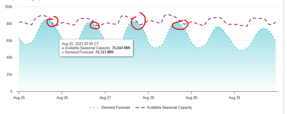

ERCOT pretty early on the projected capacity shortage watch last night.
The evenings are going to be tight through the weekend.
Jurassic Park Hold Onto Your Butts GIF
First time I've seen the projected supply to be under demand, though I don't check every day.
#1789
Check out the 6-day:
Looks like a drop in wind generation over the next few days.
Edited by Dahobbs

#1791
So this is basically when solar dies down and the gas plants are offline right?  For three straight days now, local news has been reporting that "unexpected lack of generation" from gas plants has been an issue.  I don't see how they can take stuff offline in the hottest (historically) time of the year.
#1792

#1793
It's when solar dies down yes. But the issue appears to be that wind generation is expected to be significantly down in comparison to usual for that time of day. Whether there is also an issue of gas generation being unexpectedly unavailable, I can't say.

#1800
It’s the transition from the sun going down, but it’s too hot for the wind to blow.
