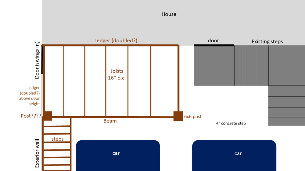

Here's a shitty powerpoint drawing of the general plan.
Idea is to do 2x10 or 2x12 ledger boards attached with lag screws straight through the drywall and into the studs along the two walls. I'm thinking I'll double the ledgers so that I can drive the joist hanger screws to a good depth. I'm not really sure how or if to connect/attach the ledgers at the top left corner.
Then put a 6x6 post at the bottom right corner, attached to the concrete as already discussed. No idea what to use for the beam. The biggest question right now is if I need to do a post at the bottom left corner as well. Tentatively, that's where the stairs will attach (assuming they leave enough clearance for the car door, if not, I'll have to figure something else out). Seems like a lot of stuff to support on just the end of the ledger board without a post there.
Joists don't need to be too big. That span is only 7-8', so 2x8s or even 2x6s will probably work. Does the joist farthest right need to be bigger, more like a beam, or is a normal joist OK there? Width is like 10-11' so I'll figure out the math for 16" oc joists.
I'll figure out what to do about railing later. Details.

Lower left post isn't needed.  I would let the ledger there run long, so it picks up the next stud. Maybe the next two studs.
I would think 2x6 joist are more than adequate.  For the beams, a 4x6 or even a double 2x6 bolted together in a few spots should be fine.
No need to double the ledger.  Use these screws into your single ledger: https://www.lowes.com/pd/Simpson-Strong-Tie-Wafer-Head-Screw-8212-8-x-1-1-4-in-2-Phillips-Clear-Zinc-Coating-100-Qty/1002965982?cm_mmc=shp-_-c-_-prd-_-hdw-_-google-_-lia-_-213-_-framinghardware-_-1002965982-_-0&placeholder=null&ds_rl=1286981&gclid=Cj0KCQjw6-SDBhCMARIsAGbI7Ujzsxl_i9ICLb9bHhuh6JLC2W57FCvLXxqlKiIugKJBZekA7NV3WIMaAjuqEALw_wcB&gclsrc=aw.ds
And the 6x6 is overkill IMO.  Use a 4x4.
Edited by Gil Bang
Good idea on letting the ledger run long, although now I can't picture how I would attach the stair stringer to that.
So lag screws to attach the ledger to the studs, then the screws you linked to hang joists from the single ledger?
everything gil said.
Yes, lag screws to attach ledger to the studs, then use the linked screws to attach joist hangers to ledger and beam. Joists sit in hangers.
simpson_lu210.jpg?bw=1000&w=1000&bh=1000
and yes, the joist farthest to the right should be more like a beam (2 2x6 bolted together).
What are you doing for the actual floor?
What's the garage floor situation?  Do you have a stem wall?  If so, that stringer needs to be inset so it hits the garage floor, not the top of the stem wall.
Don't attach the stringer to the ledger, attach both of them to the "beam" in front, using simpson hardware.
#22
I don't know how to answer this. The rest of the house is elevated on piers (flood zone), but the garage is at grade. I think it's just a good ol' concrete slab. Below about 5 feet or so, the exterior wall (far left side of my drawing) has some sort of cement board or something on top of it, meant to flood. The wall is flush all the way down to the garage floor. I don't know if its cinder blocks or wood framing or what behind the cement board. I'm attaching a pic taken during construction. This is the wall that the stairs would run down. They'll have to be steep enough to miss that electrical outlet. Platform would be at the far right, over that doorway.
So is the beam in front (bottom in my drawing) hanging from the ledger just like a joist? Or sitting on top of it?

As noted already, it’s probably overkill but I would use a 6x6 for the on post as it’s easy to notch and still have enough material to screw the out board joist and rim joist beam into it.  Something like this.

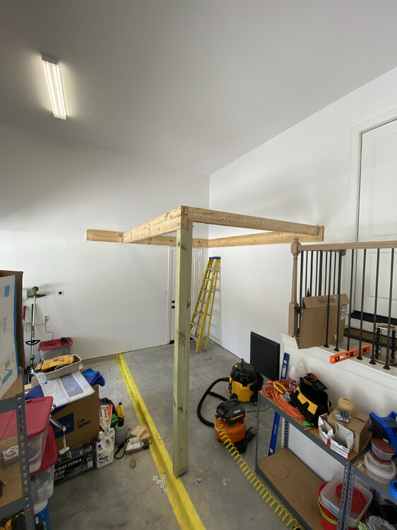

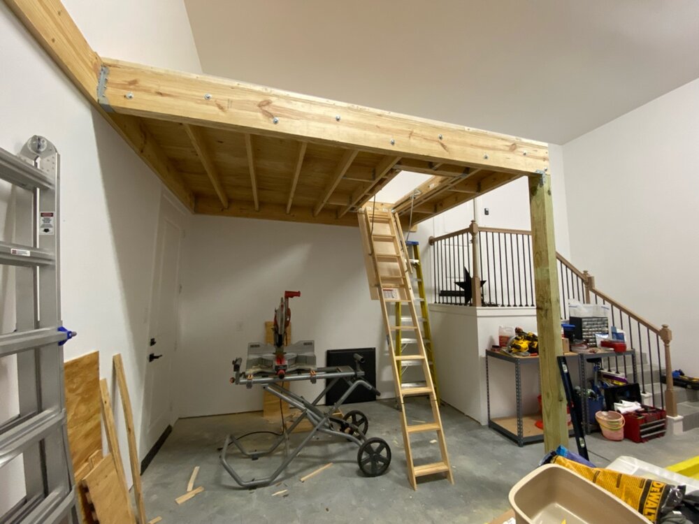

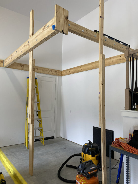

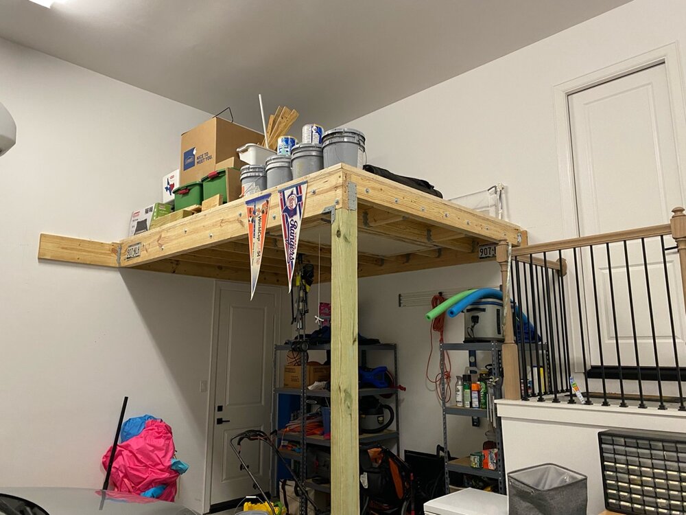

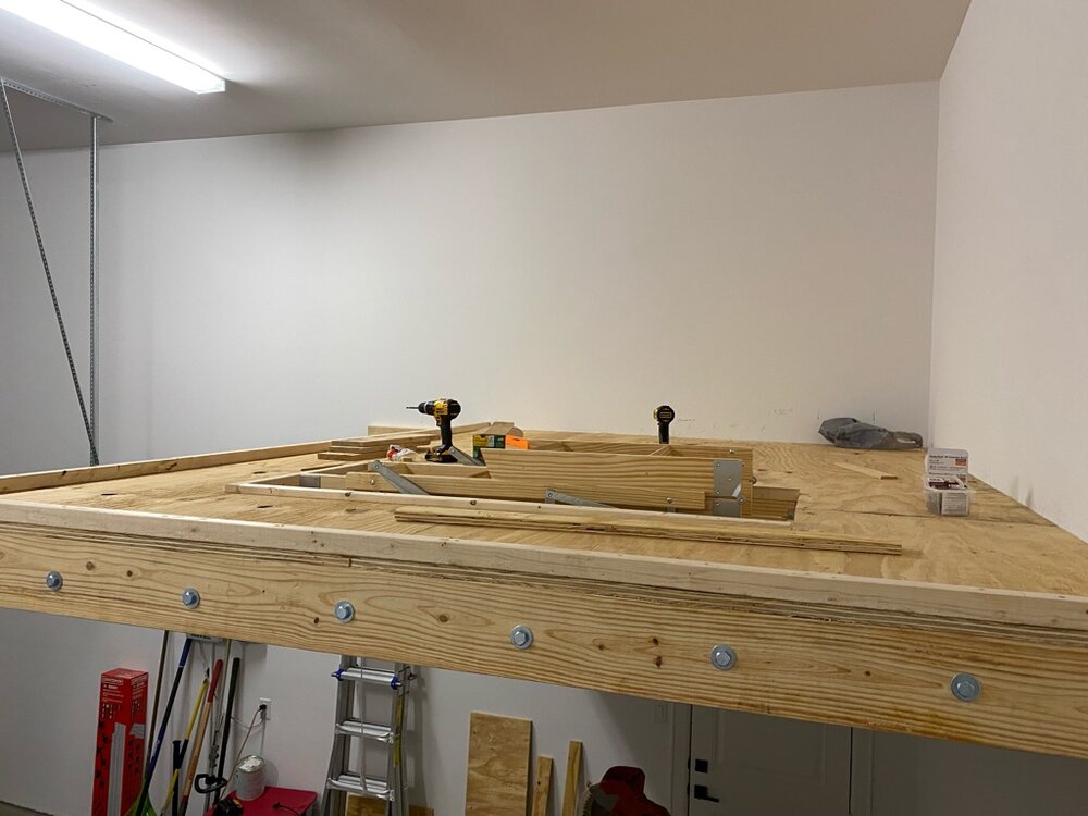

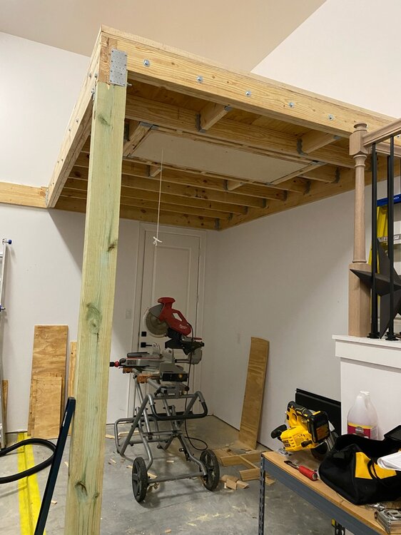

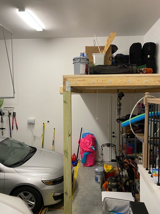

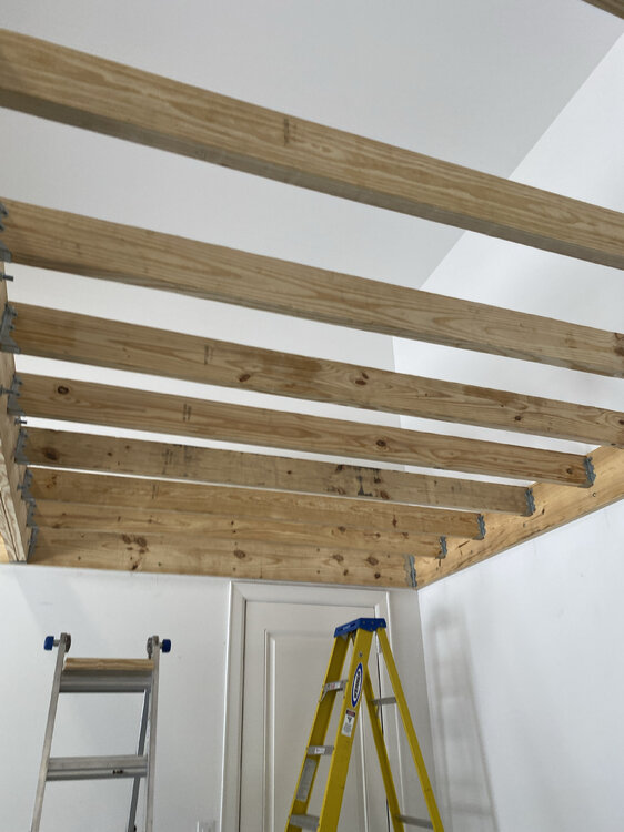

Weekend progress.
2x10 ledgers attached to the studs with 5” Spax Power Lags. The long beam is a double 2x10 and the short one is a double 2x6. Each beam is joined together with 1/2” bolts along its length. Beams attached to the ledger with double joist hangers. My wife was not impressed with my suggestion that I just leave those temporary posts and call it a day.
Post is a treated 4x6 because that’s what Home Depot had. Worked out pretty well because there’s room for both beams to sit on it. Cut it to length and notched the top for the difference in height between the 2x10 and 2x6s. The 2x10 beam is attached to the post via a 7” bolt that passes through the beam and the notch. Then I put a couple lag screws through the big beam into the end of the smaller beam. Added some metal braces on the outside for good measure. Post is sitting on a metal bracket attached to the concrete with a 4.5” long 5/8” anchor. Drilling the hole for the anchor was a real bitch with my wimpy homeowner-grade hammer drill. Perspective kinda distorts the picture but there’s about 6’ of vertical clearance above the platform, enough for me to fully stand up.
After adding 7 2x6 joists. This thing feels sturdy as fuck.
Time for some refreshment.

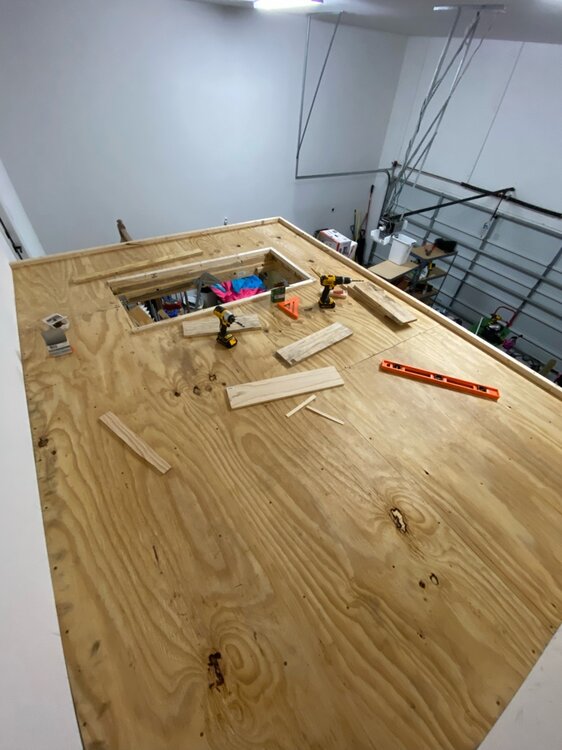

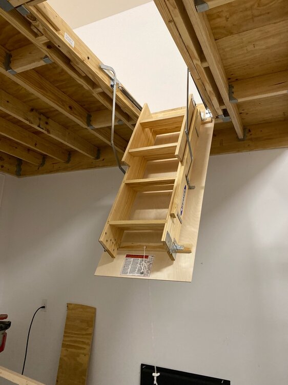

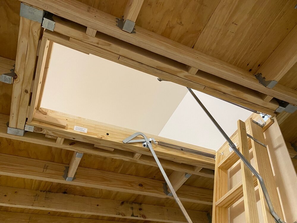

All that’s left is to add some 3/4” plywood decking and then cut a hole in the bottom for an attic staircase. I might also tack a 2x2 around the edges just to keep shit from rolling off or whatever (although I managed to get it surprisingly level). Maybe lights on the bottom too depending on how dark it ends up underneath.
I’m a little stuck on how to attach the plywood. Because I had to avoid some lag screws in places, the joists aren’t all perfectly 16” on center. The edge of the first sheet of plywood falls on top of a joist, but not centered. Only grabs about 1/4” of the joist. I’m considering 3 options:
1) going in with the deck screws at an angle. Feels messy.
2) tacking some scrap wood to the side of the joist so I have a solid surface to sink deck screws into. Easiest solution but I’m not sure how structurally sound.
3) cutting the plywood short and having it fall on the previous joist. Probably the best structurally, but I’m very skeptical of my ability to saw a whole sheet of plywood with that precision.

#26
It bugs me that both beams are not 2X10.  I could never live with seeing that everything I pulled into the garage.
Hah. Thanks for pointing that out.
I did it that way because I was thinking about the short beam as a “super joist” instead of a beam really. Since all the joists hang from the long beam, I made it beefier.
I suppose I could always tack a 2x4 to the bottom of the 2x6 for symmetry.
#28
Looks good,  that will probably be there longer than the house.    I would probably just sister a 2x2 or 2x4 along side the joist where the deck plywood hits short but if it bothers you just cut the deck.  I assume that the deck isn't more than 16' long so you would have to make a cut anyway.
#29

  • I was thinking a post at each corner, but my neighbor (who is some sort of architect) said I could also just mount a runner board into the studs and set it on top of that. The platform is in a corner, so bordering two walls. Pros/cons of 4 posts vs attaching 2 sides to wall studs?
  • How do I get the posts plumb? I assume my garage floor isn't perfect.
  • Worried about building the stairs. How hard is that? If I'm coming down from 9 feet, do I need to do a support half way up?
Looks good.
4) sister joist on the joist that is not 16" on center. Then attach the plywood to the sister joist.
Also might want to add block supports, although that might be overkill, they are quick and easy. No need to use hangers for those. Just one between each joist down the middle, more or less. Offset them from each other to make them easier to attach.
5e4c517f0bd1e.image.jpg?crop=1152,1152,0
Edited by High Plains Drifter

Why aren't you going from the elevated stairs on the right?  Just knock out that existing section of handrail and add a few steps there...
I thought about that at one point but dropped it for several reasons. Code compliance concerns, kid safety, wife-acceptable looks, and lack of DIY skills on my own part.
I do think in practice that I’ll end up shoving shit on and off from that landing. I’m still not absolutely married to this attic stairs idea, but because of the way it’s situated, there’s not a great place to run stairs down. Plus I don’t want to mess with trying to build stairs myself.
#37
Have you looked at an alternative to plywood floor?  Either a sheet of expanded steel mesh or even hog fencing if you are just going to be putting boxes up there... (looks good as is by the way...) Or make a pergola in the garage and lay down 1"x4" slats or even narrower ones..

#38
Just remembered I never wrapped this thread up. I’m sure you’ve all been waiting for the big conclusion.
Attached 3/4” plywood decking. My joists weren’t perfectly spaced so I had to cut the plywood which I was nervous about getting straight but it turned out fine. Trimmed the excess plywood all the way around after I screwed it down.
Putting in the attic stairs was probably the hardest part of the whole thing. I kind of went crazy with the Simpson hangers in framing out the opening. Actually walked over to a house under construction in my neighborhood to cheat and see how they were doing it. Lots of measuring and cutting to get the hole size just right. Damn near dropped the entire staircase unit through the hole one night. In retrospect I should have used one of the joists as one side of the frame for the stairs. That occurred to me way too late. Next time.
Final thing was tacking a 2x2 all the way around the edge to keep shit from sliding off and cuz I like the way it looks.
This thing feels sturdy as hell and as you can see we’ve already loaded it up with a ton of crap. Thanks all for the pointers.
64317612189__1754A6EF-0291-4A65-BB90-D0CCE3355478.jpgIMG_1660.jpgIMG_1661.jpgIMG_1662.jpgIMG_1663.jpgIMG_1664.jpgIMG_1854.jpgIMG_1856.jpg
#39
you did good, and gained some valuable experience.  And your wife is gonna hit that post.
