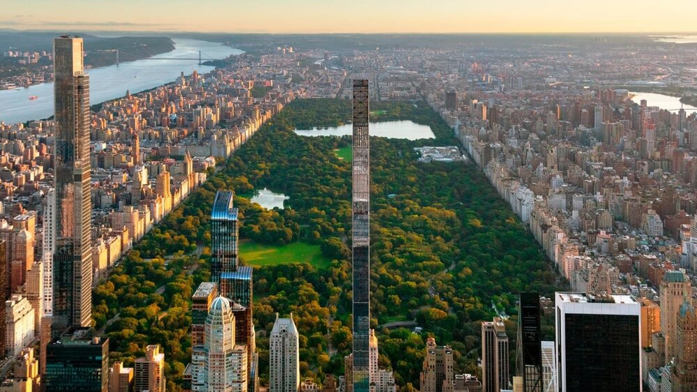

https://www.cnn.com/style/article/steinway-tower-intl-scli/index.html
The world's skinniest skyscraper has been completed, adding a new landmark to Manhattan's famous skyline.  Steinway Tower, or 111 West 57th Street, has a height-to-width ratio of 24:1, making it "the most slender skyscraper in the world," according to the developers.
At 1,428 feet, it is also one of the tallest buildings in the Western hemisphere, falling short of two others in New York City: One World Trade Center at 1,776 feet and Central Park Tower at 1,550 feet.
Im Not No Way GIF
Maybe the Surly engineers can explain it better, but I'm looking at photos of it, and trying to wrap my mind behind the size (or lack thereof) combined with the height, and looking at the base of it, and it's like "how can a good windstorm not fuck with it?"
They've said it will sway up to 5 feet during storms.....there has to be some kind of massive base going deep underground to keep it anchored, etc.

So I believe the point of this thread was for the OP to demonstrate the first use case ever for taking video in portrait mode on a phone. Actually makes sense for a skyscraper.
Massive hydraulic, damping systems in the tower counteract sway. They probably have a few floors blocked off for several of them.

PBS had a series on it called Skinny Skyscraper.  It was pretty interesting.  They built it into behind an Historic building so they had to go under that building (I think it was a Steinway museum or something) and anchor it in that building's foundation.  The foundation concrete pour was a very choreographed event.
They left a few floors as pass-throughs for wind.
Oh yeah, I remember seeing that one. The footprint, and prep was incredibly tedious because of the sliver of a building footprint.
They had a blow out of a form or concrete feed tube.  You gotta have your balls screwed on tight to run that job as a superintendent.
If that thing had been poorly designed and fell during a storm, I can't imagine how many people it would kill in surrounding buildings, and what it would take out.  I'm guessing the legal battles with the insurance companies would be legendary.
Rig it to fall towards the park like a lumberjack notching a tree :)
