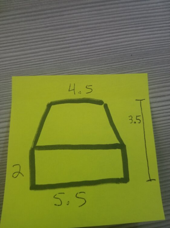

I'm screwing something up.
I got 11 for the bottom.
On top I multiplied 5.5x1.5 to get 8.25.  Then, I subtracted 1.5 which, I thought would be the area of the two theoretical right triangles on either side of the top shape.
Added to the bottpm, I got 17.75.
three rectangles.
2x5.5 for the lower one, 11.
4.5x1.5 for the upper one, with the triangles lopped off, 6.75.
The two triangles make a rectangle of 1.5x1, 1.5  Oops, fucked this up.  1.5x.5, .75
18.5.

I know the formula for the area of a trapezoid.  I'm just curious why my steps wouldn't work.  I.e. area of the rectangle minus area of the two right angles.

Triangles make a 1.5x 0.5 rectangle dont they?

Yes, see edit.

Deadshank is the winner.  18.5.
You made the same mistake I did.
The bottom rectangle is a given. 5.5 x 2 = 11.
Trapezoid:  (4.5 + 5.5) / 2 = 5 width.
5 width x 1.5 height (as evidenced by 3.5 overall height less the 2 in the lower rectangle) = 7.5.
 11 + 7.5 = 18.5.

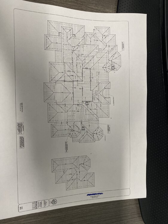

(architect prolly screwed it up but owner and builder needs a bid based on a guess)

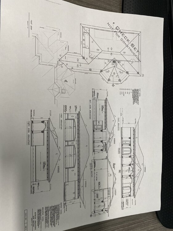

I've always been pretty consistent on drawings being correct sizes, and matching the dimensions, even when I was hand drawing back in the mid 80's. With CAD there's really no excuse for anything to be incorrectly scaled.
4 minutes ago, Onboard 2.0 said:
I can neither confirm nor deny any such charges...
It still happens.  The roof plan and exterior elevations are clearly 1/4" = 1' - 0" when referenced checked per notes on grade to clear height, eave overhang or some other static dimension.
Bottom right corner of "A" pages say 3/32" = 1' - 0".

1 hour ago, pantone159 said:
2*5.5 + (3.5-2)*(5.5 + 4.5)/2
I would do 2*5.5 + 2*1/2*(1.5*.5) + 4.5*1.5

You are all wrong.  OP asked for area, not approximate area.  There are zero rectangles, trapezoids, right angles, or even straight lines in that drawing.
