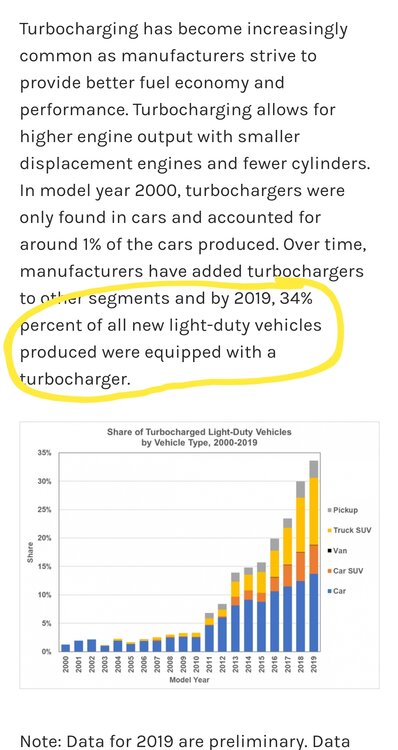

Most cars now have turbos or superchargers. If you have any forced induction it doesn't make a shit at all.
Are you retardation?
A- most cars today are naturally aspirated
2-If you have a supercharger or turbocharger you have a high compression engine.

https://cars.usnews.com/cars-trucks/cheapest-turbocharged-cars
Super weird. It's almost like anyone who wants good fuel economy has FI.  Ecoboost from Ford. Eco from any vendor. Most Subaru have a small turbo. Its weird how stupid you are even the damned Chevy sonic has a turbo.
This isn't 2010, you are the stupid one. Its not for performance anymore its for fuel economy. Shut the fuck up about things you don't know about and save yourself some embarrassment next time.
Does it hurt being so dumb? Most cars on the road are N/A. Sure MAYBE 51% of 2021 models might have a turbo/S/c,
And where the fuck have you been? When the Chevy Sonic came out in 2012 you could get a 1.4 turbo.
