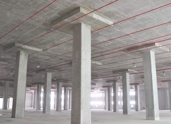

Crazy to see that deck basically punch through the columns and collapse.
After the Northridge earthquake in LA, they found many structural failures were due to decks punching through basic columns like that, so they required all columns beefed up with caps to hopefully give enough strength to prevent that in the future.  (These probably wouldn't have even helped Surfside, with the years of deterioration and lack of maintenance.)
Probably not ultimately,  but I bet that slab wouldn't have collapsed for several more years with those thickened "suspended footings".  The shear forces at that 6 - 8" thick slab to those columns  must have been immense.  That thickened slab detail would have cut those shear forces down considerably.
fair point
but this place was built in the early 80s and the Northridge quake was in '94, so that tech wouldnt have been part of this structure.
2 minutes ago, AUS-97HORN said:
fair point
 That thickened slab detail is meant to absorb lateral force movement usually so it's probably a seismic zone detail to begin with. That thickened detail wouldn't have been called for in Florida even as a wind loading detail since it was at an on grade slab
