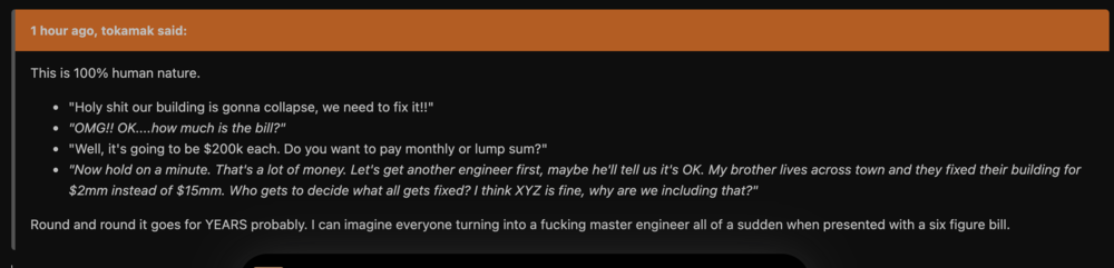

I bet it went down exactly like tokamak said:
