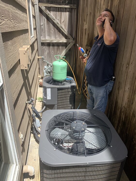

July 6, 20214 yr Helping a neighbor sell his townhouse. Figured it’s good to have the AC units serviced prior to inspection. Two systems. One 2005. Other 2009. Both R22. One full of refrigerant. Other needed to be topped off. Also blew out the drain lines with compressed air. One was blocked. Total cost $300. As we were settling the bill, AC Guy exclaims, “Prices for 410A have gone WAY up.” Tripled in the last month. AC Guy’s son says imports have been halted for unknown reasons. Bernard

July 7, 20214 yr 20 minutes ago, Jkwellborn said: Man there just isn’t much room around those units. Yep. That’s life in the big city. Mine are worse than that. Work just fine. 🙂 Bernard
