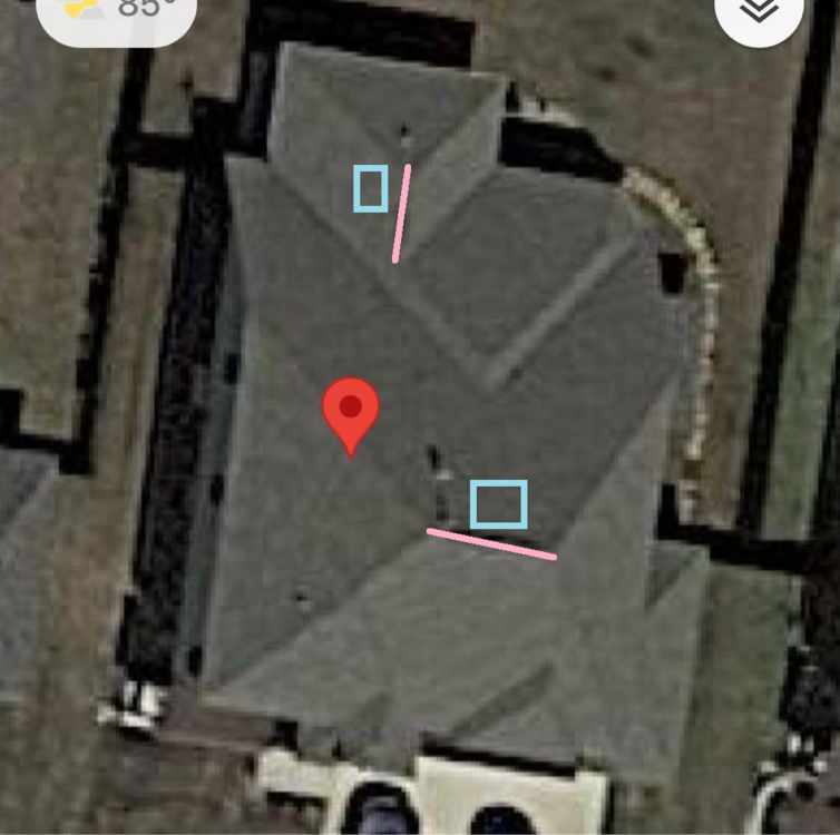

Turns out hail means I’m getting a new roof. Totally forgot about ROFL BOX, my bad, or I’d have reached out. We are going with Crest Roof and USAA has already sent us the cash.
The brochure from rest mentioned solar vent fans. I asked and the guy from crest suggest one solar vent fan and two box vents to bring the temp down. The roof guy said we could buy them and they’d install them.
Our AC is in the attic and has trouble keeping the house cool enough during the summer.
Are these worth it? Which ones should I lean toward or stay away from?

2.  Need to see an overhead view of your house.  Go to Google Maps, find house, zoom in & show only the roof (+ maybe a bit of the yard, whatevs).  Paste pic into MS Paint, edit out as needed... then copy the entire image, paste here (if using a computer... otherwise, screenshot on phone, crop / edit & post via TapaTalk).
2a.  I can't make a suggestion without seeing the roofline... the GAF versions are good & Attic Breeze is well regarded (in the proper sense, not Shag lexicon).  If you have a mostly hipped roof (pyramid type shape), then yes, a power fan (solar or hard-wired) is a good way to go.  The benefits of solar is you won't need to worry about a drunk electrician who wired something wrong & it fails or catches the house on fire.  The benefits of hard wired is they have more power & will slurp more air out of the attic.

Based on that layout, I would only do a power fan in these two spots (blue squares) & if ridge vent, in these pink lines.
Keep in mind (& it is possible that your saleshole doesn't actually know this):
1.  ONE 4' piece of ridge vent has the same air flow as 4 'static' vents (holes in the attic, whether a turbine or any other covering device).  This is according to GAF, the largest shingle manufacturer in the USA.
2.  If you buy a turbine, it will cost around $ 40.00 for a quality unit.
2a.  One single stick of ridge vent retails for around $ 10.00.
2b.  This would mean that a single piece of ridge vent costs 25% of the price for a turbine, but a turbine gives you 25% of the air flow on a single piece of ridge vent.
Also... intake opportunities are important.  I am assuming your house was built within the past 20 years & if so, that means your soffit is most likely a Fiber Cement product & has air flow all over the place... lots of holes to allow air in.  & That's good.  "Balanced" air flow for a good "Ned Free Air Flow" (NFA) is what you're after.  Gable vents don't suck (nor blow) all that well so if you have a gable roof, stick with ridge vents.
Finally... you probably won't see a lower AC bill for the new attic fans or a ridge vent.  Proper insulation, quality sealing around windows & AC ducting & doors... all of that affects your interior comfort & leaks that send cool air into the attic / hot air pushing down into the house.  YES, a cooler attic is important.  Your equipment in the attic won't suffer quite so bad from insane summer head (easily 140 degrees on a quality hot day) & shingle manufacturers specifically say that you need to have good air flow to prevent cracking & other long term damage to the shingles.  Bad air flow can void your warranty.

Forgot to include the pic.
...AND... you do not mix exhaust products, meaning no ridge vent AND any other hole in the roof within a minimum of 10 ft. apart.
So my pic is either / or, not both.

The house is 6 years old and yes the soffits have holes in them.
I’m assuming powered vents are better than non powered
That back section is the covered patio, if that matters.

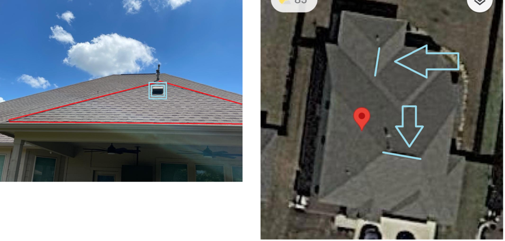

1.  He never said the COMPRESSOR is in the attic & I assumed that (like prob. 90% of modern houses) that his air handler is the part that is occupying the attic (that's why I mentioned the equipment suffering... the air handler will get an easier life if the attic temps are reduced).
2. re: insulation, I am slowly becoming a "not fan of" spray foam because we have in the past 5 years or so encountered probably 7 or 8 spray foam houses where the exact source of the leak cannot be determined due to the foam.  Leak shows up down here, point of origin is... um... well... somewhere up above?  Dunno.  Water got between the deck & foam, then ran down slope quite a ways before it finally popped out somewhere.  Even worse if under a metal roof.
Back to your roof layout:  hot air is still being trapped here, even though it's the porch.  It has a fully intact "underside", so the air isn't moving out, only up (pic 1, L side).  This one measly little exhaust vent wont qualify for your shingle manufacturer's warranty against delamination.
Add ridge vent here (pic 2, R side).
Thanks again.

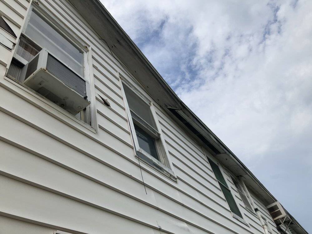

@ROFL BOX or anyone else that might be able to help me with an insulation question
We have a home in Galveston with vinyl over shiplap built in the 40s. I believe it has a decent amount of insulation in the attic, but it has no insulation in the exterior walls. It has a ~1” foam board begins the vinyl siding.
The ac seems to work mor than I feel like it should. We have 1/4-1/3 of the siding we need to replace, and I was wondering if it would be worth the trouble to pull down all the siding cut a 2” circular hole through the foam between each stud and blow in loose insulation. I’m concerned that the shiplap wouldn’t prevent moisture from getting in. Would I need to cover the foam in a moisture barrier after that?  Am I better off removing the foam?
It obviously would add quite a bit of work turning a large patch in to a complete siding redo. Is it even worth my time, or would I be better off blowing 8-12” more in to the attic?
for reference we used 2700 kWh last month  in a 21-2200 sqft home.
Edited by UT_OB1

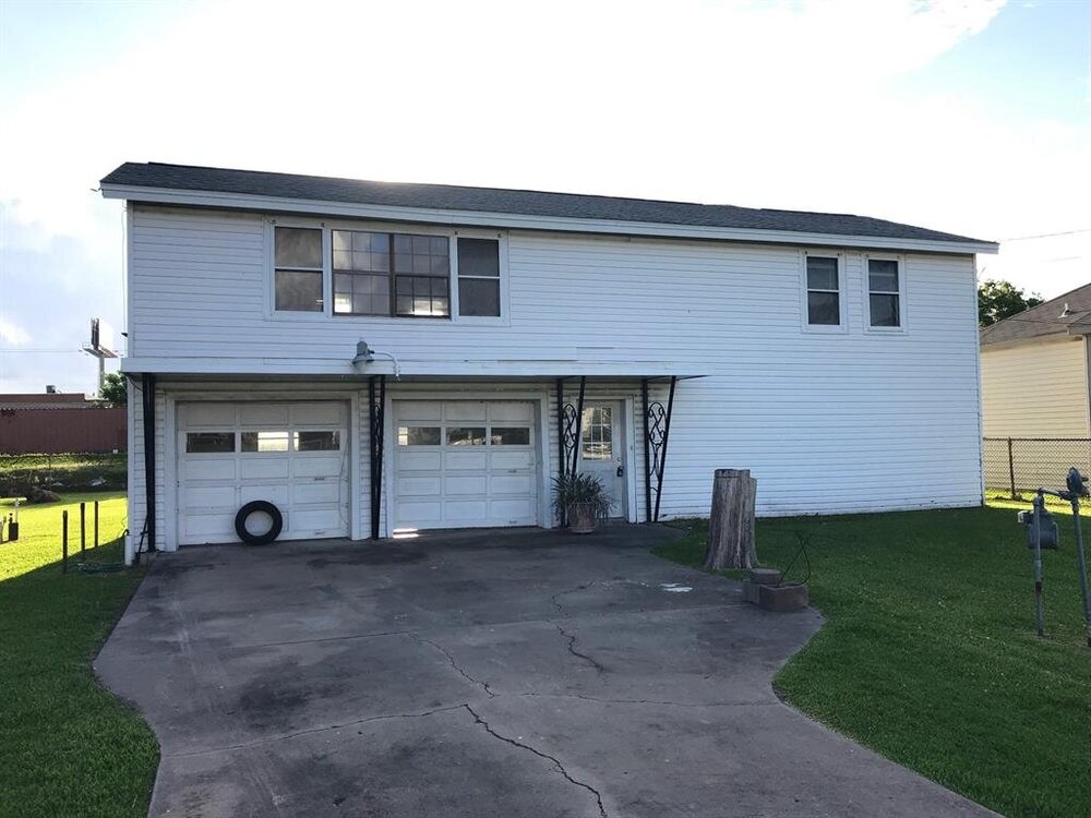

Can you post up a pic of the siding?
1. I am assuming very few trees on the Western side (coastal area, etc)
2. What color? Dark = heat. More & more, for a "beach-y" vibe I am a fan of pure, snowblindiinglywhite & soft blues or a minty light green as a contrasting color.
3. In the pics, I would like to see what your soffits situation is like.
4. The shiplap wood is great as a nail able surface & I see no reason to take that off unless there is some other reason i don't know about.
5. Sight unseen, I might suggest removing the vinyl, staple on some batts or rolls of R-whatever stapled to the shiplap, then some R-max pegged on over the batts (getcha some long plastic caps & if you're adventurous, even a "Stinger" plastic cap gun... I have no idea what the maximum length is that it will shoot).
Vapor barrier ("house wrap") over that & then your vinyl. Hand nail the replaced vinyl siding to secure ¡¡HOWEVER!!! you need to make sure it isn't too thick a package from the vinyl to the shiplap.
Long roofing nails are available, however you do need to measure the depth needed AND don't make the nails penetrate too deep because the siding needs to expand / contact with heat, cold, etc.
Again, we need to see some pics.

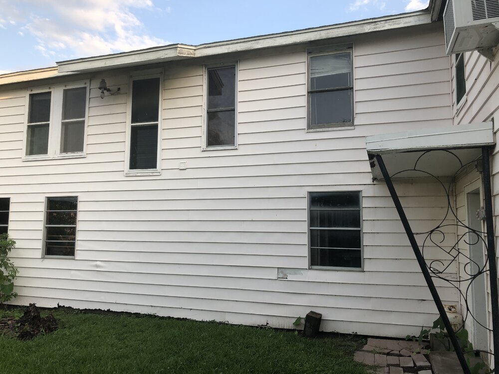

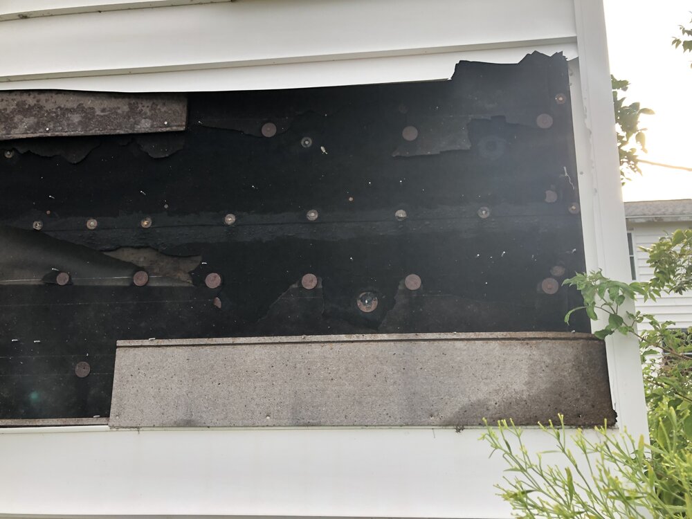

Let’s see what I can find…
Here we go.  Third picture shows how all the soffits are “designed.”  There’s about 25’ of that total around the house.
The previous owner replaced about 2/3 of the siding at some point and it is still functional, just not the prettiest in the world. The back part of the house that wasnt replaced you can see in the worst of in the 4th picture.  It had gotten very brittle and cracked, and recently during one of the storms it took a section with it (lightning also struck the transformer on the street and blew it and one on pole 50’ away up)
There was vinyl siding there. Under that black paper (is that for moisture?seems like wrong material) is a foam board, and under it is the shiplap.
1. In a storm, if you file a claim due to a covered peril (damage) & this pattern is not available any longer (measurements, not appearance), insurance policies should get you a minimum of an entirely new wall.
2. Lighter colors are good for less heat, won't absorb the sunlight or hold heat.
3. The "black paper" is old school, but a functional vapor barrier. Probably 30 pound.
4. If it was me, I would follow the plan laid out prior & use that for the best possible mitigation. Maybe even swap out vinyl for Fiber Cement. Is vinyl required due to "we want this to wash out in a hurricane" type codes? Maybe for some kind of new construction but not for a grandfathered structure where the shiplap was already in place & you are going back over that.

The part that was knocked and damaged by the storm is probably $200 worth of vinyl, not really worth going through insurance. I should probably keep it to just a patch job, but I kid of want to do a bit more of the house that is older if I’m going to do that. And like you said, cement board would be better, so in my head I’ve moved to why not just replace it all?  And if I’m doing that, I’m thinking I should try to add insulation for the exterior walls.
I wasn’t planning on pulling off the shiplap. You mentioned stalling up some batts or rolls to the ship lap. How exactly does that work if I’m stapling to the exterior of the shiplap and don’t have the studs to crest a gap?  I’m just picturing flattening the insulation out when I put the cement board (or vinyl) siding on top of it.
