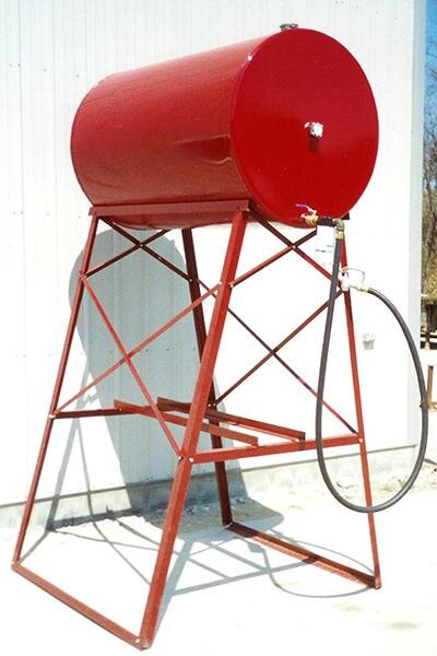

Deadshank has the correct answer. Get a 500 gal tank on a stand.
16 hours ago, deadshank said:
If you’re gonna do it the. Get one of these.
4 minutes ago, NeverMarryAStripper said:
After you take that and get it filled how do you lift it up on the stand?
One that big, they deliver.
Properly ground the tank.  If you don't keep it really full the inside will develop condensation.  So you will need a way (occasionally) to check for H2O and drain it off.   Don't store any oxidizers (pool tabs) near it.
Just don't fucking do it at all.  It's a really, really bad idea.   Ask any fireman if they have a story about somebody that stored gasoline.  They will have one, and it won't have a good ending.
Get a fucking generator that runs on Diesel or Propane (not fucking butane...that's a bastard gas).
Propane is pretty fucking safe to store. Diesel is "fairly" safe to store.  Gasoline is a bad day waiting to happen.
Well, if you fill up some barrels and your pickup bed is decently high, you are part of the way there.  Just need a small pump to get it the rest of the way.

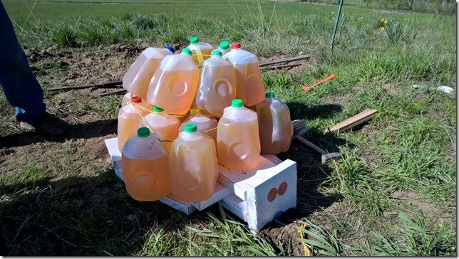

On 10/22/2021 at 3:32 AM, 52-80 said:
great shooting target
I don’t think that’ll blow up. Needs ignition of some sort, like a small jar of gunpowder that you shoot first.
whatever it takes!
