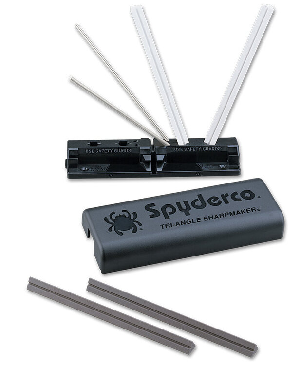

Spyderco Tri-Angle Sharpmaker.
Simple and extremely effective. Good knives will be like razor blades.  Cheap knives will be very sharp.
Got one of these for Christmas. I feel like the stones are a little short for big kitchen knives, but it certainly worked. I also feel like I kinda “get” it now and might feel confident working my way towards just using a stone.
 My little kershaw I keep in the kitchen for boxes and shit is also SHARP now. Need to do the bucks.

The key to using the Spyderco product is moving your whole arm left and right while keeping your forearm perpendicular to the sharpening triangle  and not keeping your elbow in the same spot and just moving your forearm at left and right angles.

Also true of whetstones.  The more of your arm you use (easier with bigger stones), the easier it is to hold an angle.  If you're using a smaller stone and working mostly with your wrist, you're probably fucking up.
