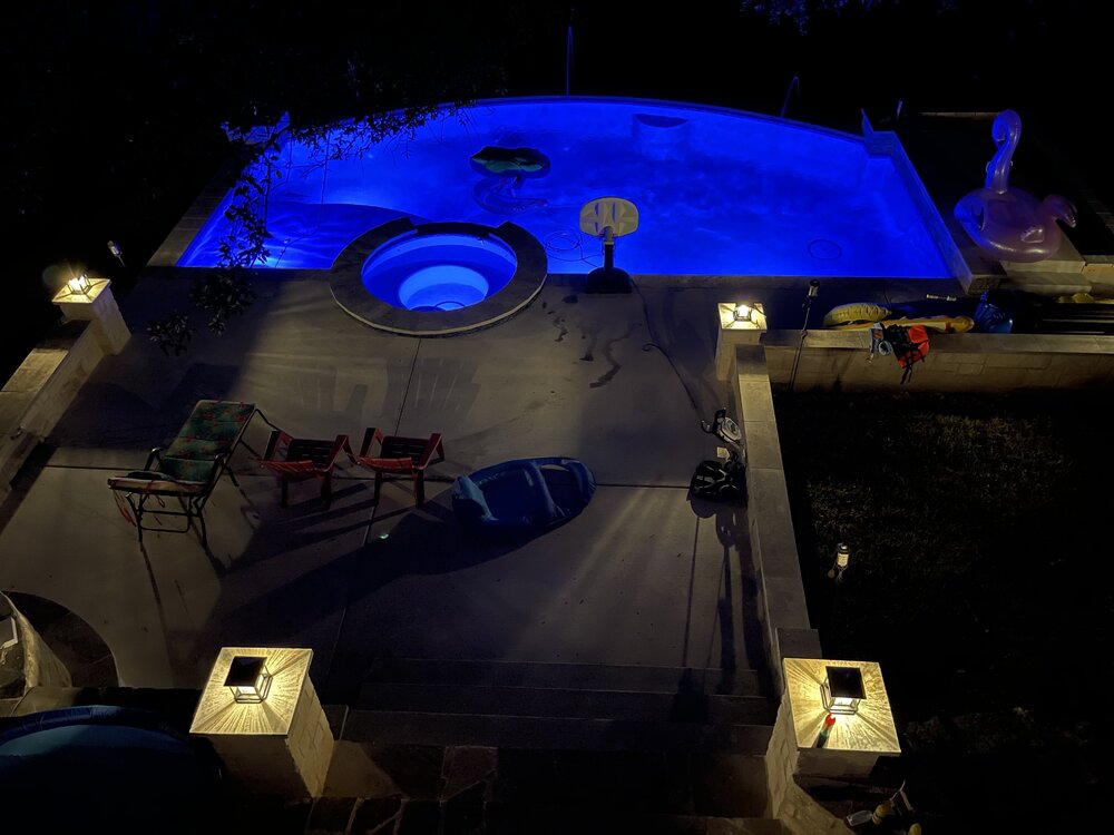

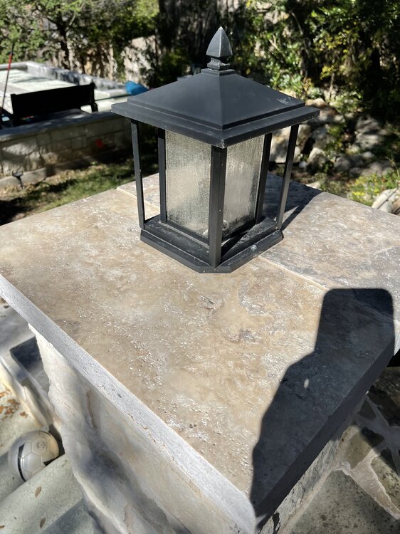

I found that the 12V options were way overpriced everywhere.  I ended up buying these 120V post lights and then using 12V LED bulbs in them wired to the 12V transformer. Fixtures and bulbs from Amazon.  Some of the fixtures had the post mount option.
