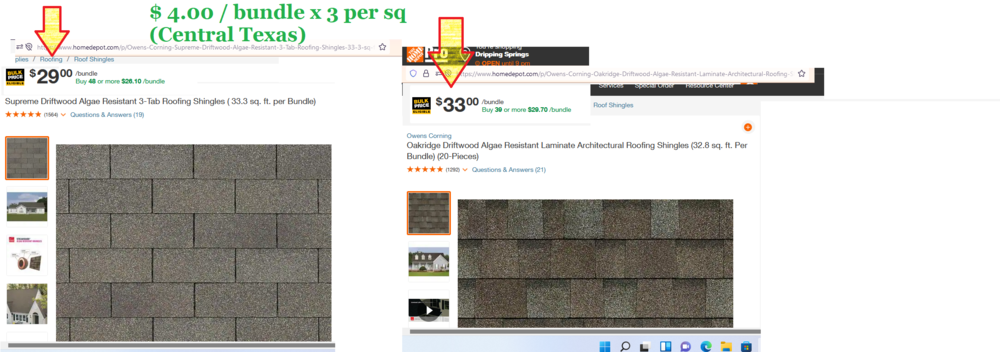

Does architectural = dimensional on shingles?  If so, best price I’m getting from HD is about $18 per square more (~25%). Is it worth it on a triplex that will be a rental?
Also, I’d like to add I hate the term/unit of measurement that is squares.
Where is the project?  Has this already been discussed?  Don't make me read 38 prior posts... I'm lazy & need to get the docs finished for another Shagger... shouldn't even be in here screwing around.
$ 12.00 per square... so I was off a bit, but def. not $ 18 per square.  & it's even less $$ difference on a "bulk" purchase (16 squares or more).  & If I buy through the "Bid Room" the other items on the ticket will also cost less... vapor barrier, lead jacks, correct sized drip edge, silicone, ridge vent, starter, nails, etc.
Also... imagine this:  in 15 years you're selling the property.  50% of the life span left (15 more years) vs. only 5 years., or 25%.

100 square ft. (5' x 20'... 10' x 10'... whatever... is referred to as a "square".  Your average double wide mobile home is around 24 "squares"... 2,400 square ft. of roof area.
