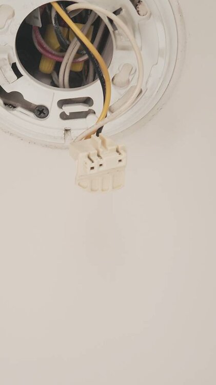

The smoke detectors in our house are over 10 years old and they need to be replaced. The old ones are Firex, with a harness that plugs into it from the back. All 5 of them are hardwired into the circuit. We bought some combo fire/carbon monoxide detectors yesterday from Lowes and the mounting and harness are all different, but i think it's a different brand. I guess I assumed they would be universal. I'd really like to avoid redoing all the mounting, I was hoping to just buy some new ones and screw them right onto the plastic. Any ideas? 20220131_160236.jpg

These don't have carbon monoxide, I have separate detectors for that.  I used these when replacing hard wired smoke detectors.  They have wiring harness adapters that make it easy.  Also the battery compartment is on the front so you don't have to remove the smoke detector to change batteries.
https://www.homedepot.com/p/Kidde-Firex-Smoke-Detector-Hardwired-with-9-Volt-Battery-Backup-Front-Load-Battery-Door-Adapters-Included-Smoke-Alarm-21029886/100246185

If you want to do it easy, get this model:
https://www.homedepot.com/p/Kidde-Firex-Smoke-Detector-Hardwired-with-nine-V-Battery-Backup-Front-Load-Battery-Door-Smoke-Alarm-4-Pack-21029887/202029423?MERCH=REC-_-pipsem-_-100655553-_-202029423-_-N
Then buy these adapters.
https://www.amazon.com/gp/product/B00K2C39I6/ref=ppx_yo_dt_b_search_asin_title?ie=UTF8&psc=1
The detector model is newer, and you will have to replace the bracket, but the new bracket uses the existing screw holes and is slightly larger so covers any paint issues.  You basically loosen the screws a little bit, twist the old mounting bracket off, put on the new one, tighten screws, plug the adapter in and twist on the new unit. I replaced all 10 of the same kind you have in my house a while back and it took maybe an hour.
They don't have carbon monoxide, but you can buy some a couple of plug-in ones if you need them.

I did the same with all of mine three years ago. I can’t give you a how-to, but it was very easy, even though the base plates had to be replaced too. The replacement units I bought all came with several different adapters in each package to match the actual alarm device with the existing wiring in the wall of a 1994-built house.

I can confirm all of this, recently replaced the same older Firex.  They had a different mounting bracket, but the screw holes were in the same place.  My house is only 1800 sq ft., so I didn't bother messing with the communication wire.  I also didn't know they made an adapter and just rewired them, which is no more difficult than wiring a ceiling fan.  The only thing I would add is to buy a premium 9 volt battery so you are not replacing them all the time.
