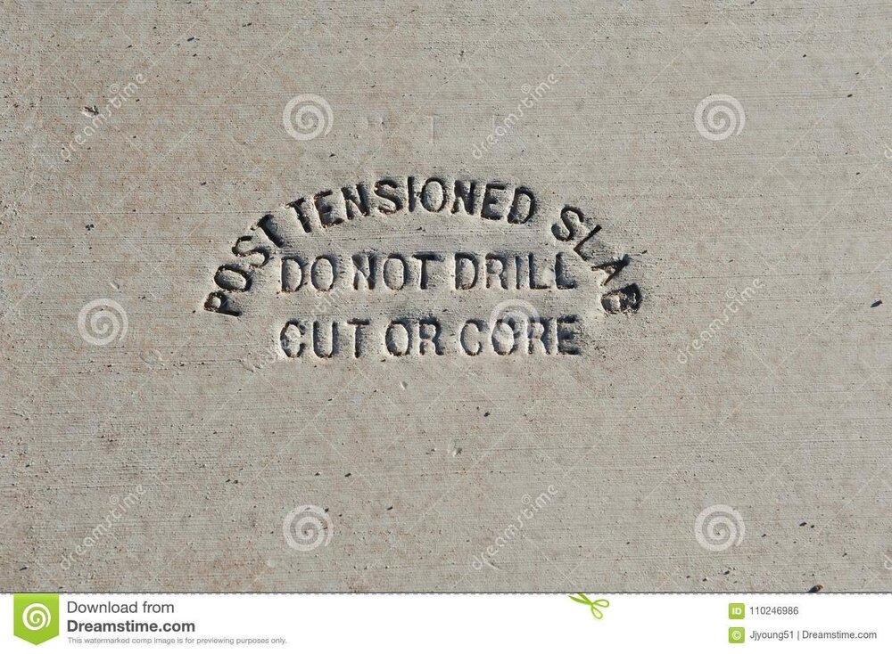

* i don't know shit about Texas slabs, but I've seen my share of foundation issues out here.
** post-tension slabs are the way to go

Until you want to remodel and add / move plumbing in the slab.
