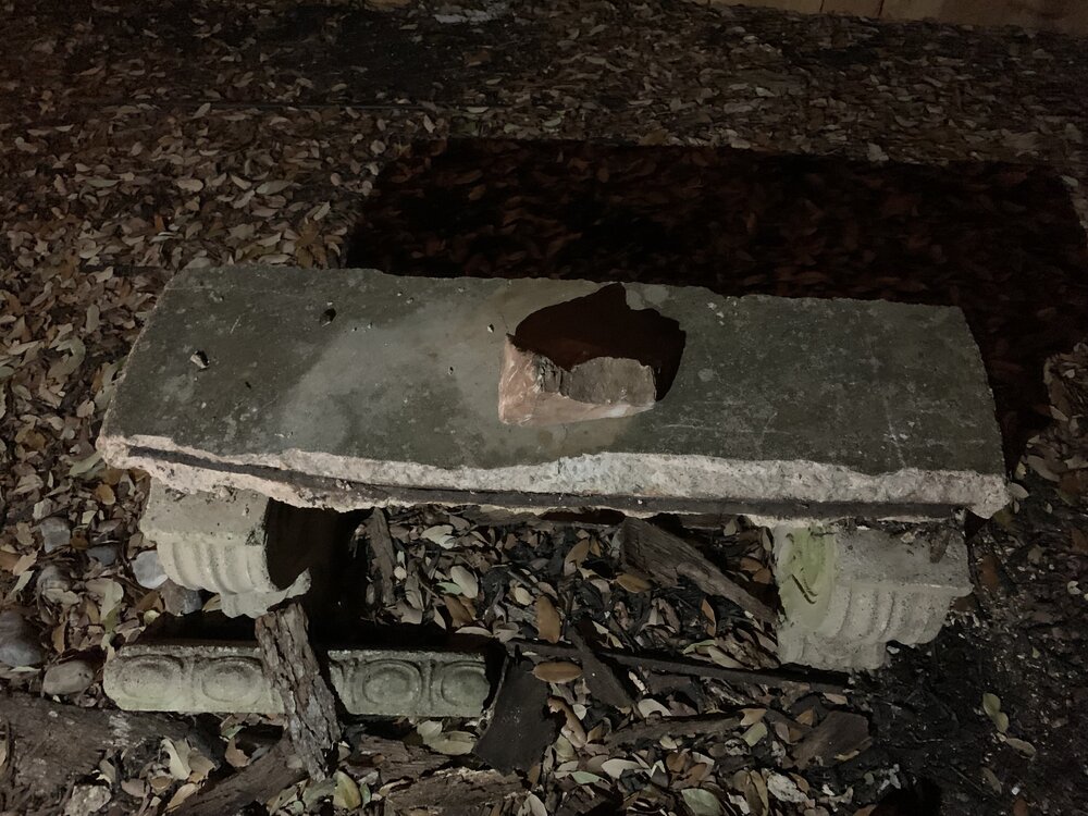

This absolutely pains me to post…it’s got my wife crying and I am in shock.  My normally exceptional 8yo apparently took a river rock to an antique stone bench and broke off the edges…it is/was a prized possession by his godfather (!) as it was one of the only things he got from from his deceased grandmother. Pieces are scattered around the yard.  He did this at a super bowl party when the adults were preoccupied.
See photo.
My son is going to face severe consequences including likely selling his Switch.  I ask for the power of Surly here if anyone knows a firm in Centex that could even take a look at this…provided they can even recover the bulk of the pieces.  ThanksA041D1B1-F0E7-4388-B9E5-07D3612B40A8.thumb.jpeg.e50a4f8b2115cc31e7a981b4c9c3a7e5.jpeg

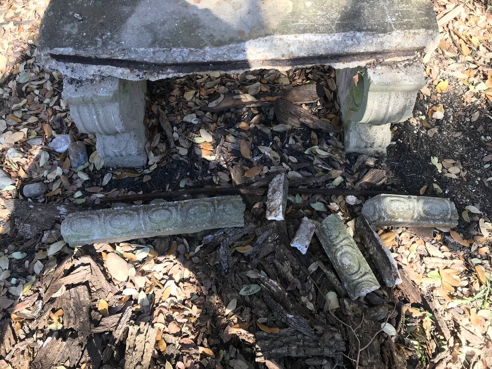

To note it’s just the trimming around the edges that are broken off.  The legs and rest of it are ok.

You have a before picture?  Does it have something sandwiched between the top and bottom?  Maybe some better pictures of current condition?

Ok will see if I can get anymore.  I think that the black strip is something that was used to start forming it when it was made.  I don’t know.
I guess I want to know if anyone has suggestions on what kind of firm could maybe try to fix this…quick google search got me nowhere.  Headstone repair?

Definitely fixable, but would likely require drilling and adding in rebar and using something like quickrete.  Could be done but doubt anyone would do it other than maybe doing it yourself. It also won't have the character it had so might be better to let sleeping dogs lie on this one as far as repairing goes since it's really the sentimental value that was important.

I have no idea but my gut says it’ll be cheaper and easier to just replace the top and keep the feet.  It would take a while for it to get dirty to match the rest of it.

Are you sure it is stone? (when I hear stone I think natural stone that was carved).  This looks like concrete that was formed in a mold and the dark center part is the reinforcement/rebar.
If concrete, they are for sale all over the place.  Multiple places on I-35 between Austin and San Antonio alone.  You can look around for a copy that used the same mold. My dad taught me that you can age/weather the concreate by using some yogurt in a mix with water to encourage lichen growth.  Google that.

However, with respect to repair it is likely to be tricky because it is concrete and not a clean break so to speak. That style of garden bench has been made for many many years. Originally, they were carved stone, but I think they've been made from concrete and in production for over a century. My late father was in the ornamental wrought iron business and he used to buy those benches and urns and things to use as display pieces to highlight his work. I will say that some sources are better than others with respect to quality/durability, but I don't know Texas all that well as this was in another state. I've seen them at the big box stores, but I'd be more inclined to go to a place near you that is more like Frazier's Concrete (near Hempstead) that specializes in concrete production pieces. Like was stated before, you may be able to acquire just the top.
If you go with patching it up, I'm not sure how well it will hold up. The sentimentality of the piece makes it more difficult to make the choice, so I can understand wanting to do so.

Going to explore options but a top replacement seems the best bet to make it work.  If it really was stone I doubt he’d be able to chop away at it like that.

If it was carved stone it wouldn't have the metal in it. Going off what I can recall, the cheapest are the basic concrete benches, which are what my father used since his primary focus was on his own work. I think you can also find cast stone which also uses a mold and is made from better materials or maybe more refined(?) but it is essentially also made from concrete. The better outdoor garden stuff is made from this. My dad had some small molds around like that that he used to make lion heads from to duplicate the brass ones that he would put on his gates. Carved stone would be hella expensive, hella heavy and would be something like marble or granite.

A cast stone fabricator could make a new top piece for you.  You’d have to give whats left of the original and they would use it as the form to make the new mould.
It won’t be cheap but it’s less expensive than a hysterical wife with a newly formed drinking problem that will use you as the target of derision.
Do you know a cast stone fabricator that owes you a favor?

That bench is the #54, 60" version in just about any garden center.
