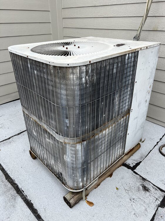

That’s good news.
As a note, the  4x sleepers under the compressor need to be replaced and the new ones need to be installed on walk pads.  The mod bit roof membrane appears to be new.   The roofer should have done that.   AC constantly vibrating will dig a hole in the roof membrane.
Good tip. Thanks.
