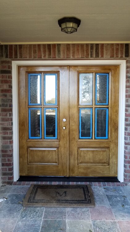

Stain is Old Masters
We went from a single door to a double.

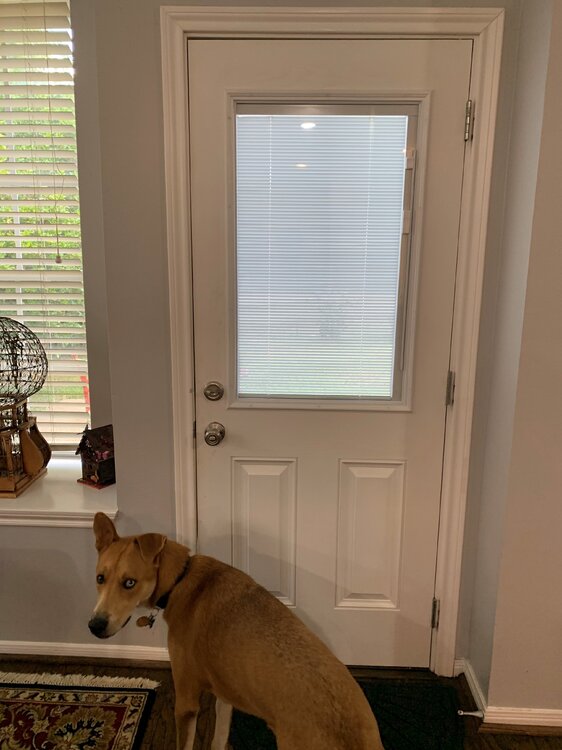

Sebastian looks like he's asking where his dog door is
