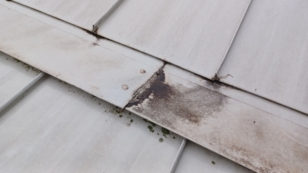

One variety of roof panel in the "Hidden Fastener" systems that @deadshank didn't mention is a Snap Lock panel.  If considering a metal panel for my own uses / needs, I would go with as bright a white color as possible & use a Snap Lock in the new(er) vertical seam.  You can easily disassemble panels if needed & do repairs.  Think the possibility of a tree branch falling or the neighbor's fence / trampoline / lawn furniture bouncing off the roof - in most situations, a Snap Lock can easily be undone with a rubber mallet & screwdriver.  Repairs to a mechanically joined Standing Seam panel system are difficult because once you
[ originally fold / seam - unfold to try repairs - try to seam / fold the panels back together ]... that's 3 bends & the metal is probably going to end up breaking on one of the folds.  Before long, the repair panel is going to break.  Then you have to put in a new panel & that next joint over is gonna break as well  before it's over, you removed & replaced an entire section.  We're going through that on a repair for a $ 750,000+ dollar custom house out here in Drip.  Zero trees but there is a leak @ a pitch change on the back porch & it's got a vaulted ceiling with zero attic (look up, see very pretty 1x6' & there's not much above that other than 2x8's, insulation, *maybe?* [Decking?  Battens?] & then the metal panels.  Builders @ best give a 1 year warranty - your new refrigerator for the new house is given a longer warranty.
Pic 1 is the repair we are discussing with the property owner (the dark parts are ponding water that has dust, pollen & other airborne bits settling in it (not uncommon (but is generally over where the water penetration is showing through the vaulted 1x6's & inside the house).
Pic 2 is the common Snap Lock profile & view for the newer systems.  Keep in mind that there are very few actual roof profiles & Company A wants you to think they have some trademarked & exclusive panel while Company B who also has the same profile wants you to know THEY have the actual better panel with ThEiR trademarked name.
