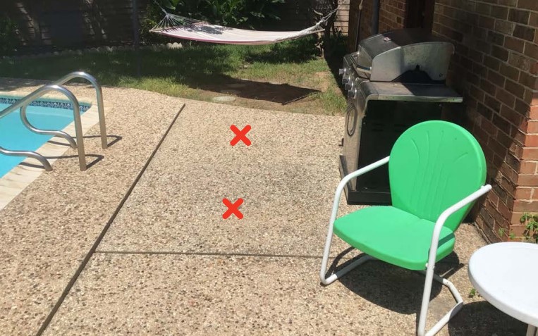

I used these guys to level our concrete pool deck patio last year https://texasconcreteraising.com/
CRC Concrete Raising
It was expensive but they did a good job.  Had it settle 1/2 " again during drought but they came out and fixed it again as a warranty call.  They didn't hesitate at all.

The area was roughly 4 ea 8'x10' slabs ---> $2,600 w/ 10% cash/early pmt  = $7.30/SF
