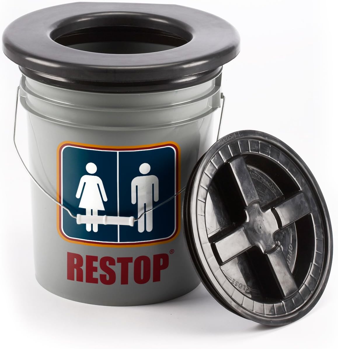

#15
Just set this in the corner. Behind a hastily constructed barrier involving a shower curtain.
